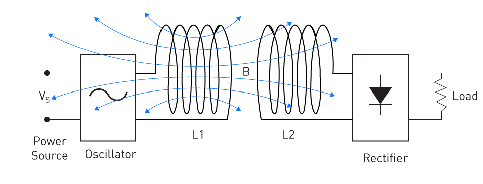

Inductive Coupling: This is a technique that involves the use of two coils, with one of them functioning as the transmitter and the other as the receiver. When an alternating current flows through the coil of the transmitter, it generates a fluctuating magnetic field. This magnetic field results in the induction of a voltage across the receiving coil when it is brought close to the receiving coil. This is the most well-known type of WPT, and it is currently being utilized in a wide variety of applications, ranging from electric vehicle chargers to toothbrush chargers.
Figure 1: Concept of Inductive Coupling Power DeliveryXXXX

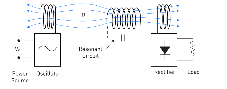

Resonant Inductive Coupling: This technique is an advanced kind of inductive coupling in which the transmitter and receiver coils resonate at the same frequency. It is referred to as resonant inductive coupling. In this manner, they are able to transfer power over greater distances and with greater efficiency in comparison to the conventional method of inductive coupling.
Figure 2: Concept of Resonant Inductive Coupling Power Delivery

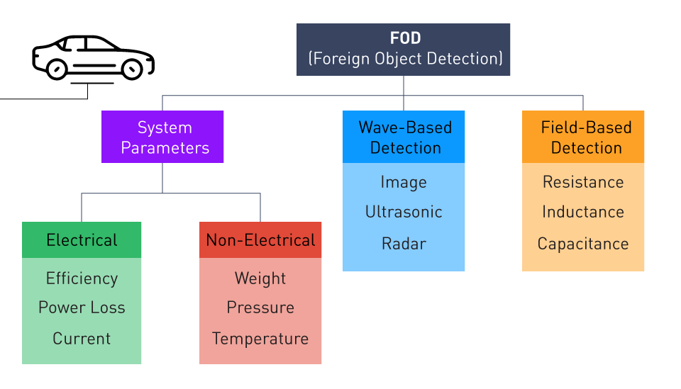

Foreign Object Detection: Metal objects that enter the WPT's field can become heated up as a result of induced currents, which can pose a potential risk of fire. This is referred to as foreign object detection. In order to mitigate this issue, contemporary WPT systems incorporate foreign object detection, which either stops the charging process or notifies the user who is using the system.
Figure 3: Different Methods For Foreign Object Detection
