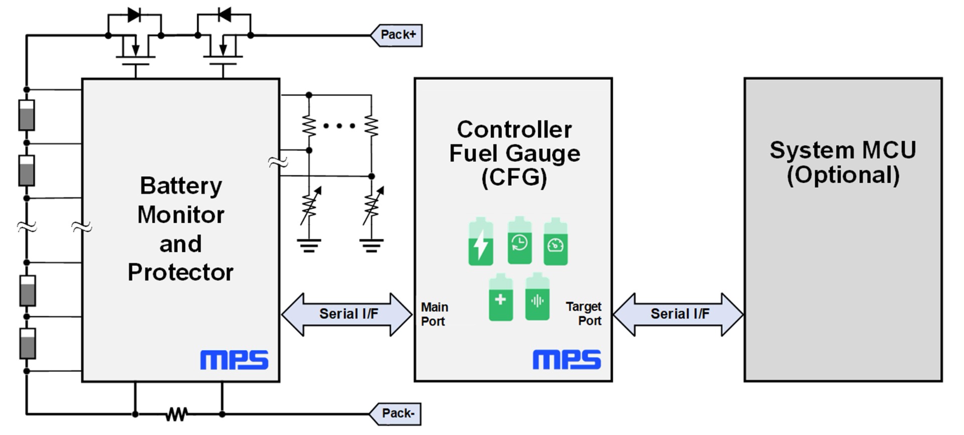

This application note provides an overview of MPS’s fuel gauges, including their operation and proper configuration. It covers MPS’s standard fuel gauges (SFG) and MPS’s controller fuel gauges (CFG). While both fuel gauge types share the same fuel gauge algorithm, they support different system architectures and implement different state machines. The SFG is controlled via an intermediate microcontroller unit (MCU); this MCU extracts the battery measurement data from the battery monitor and protector (an analog front-end (AFE)) and loads this information into the SFG (see Figure 1). The CFG directly controls an MPS AFE, so no intermediate MCU is required (see Figure 2). When this application note refers to commands to the CFG, this also describes the commands between the CFG and the AFE device.
Figure 1: BMS Architecture Based on an MPS Standard Fuel Gauge (SFG)
Figure 2: BMS Architecture Based on an MPS Controller Fuel Gauge (CFG)

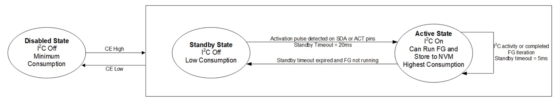

Standard Fuel Gauge (SFG) Operating Modes
Figure 3 shows an SFG power state diagram. See the Communication section for details on the process of changing power states.

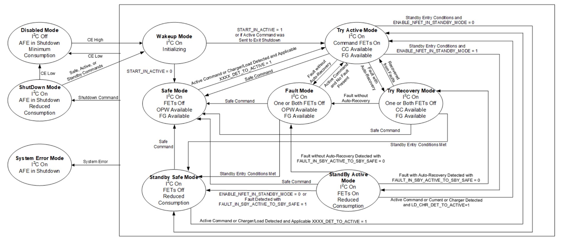

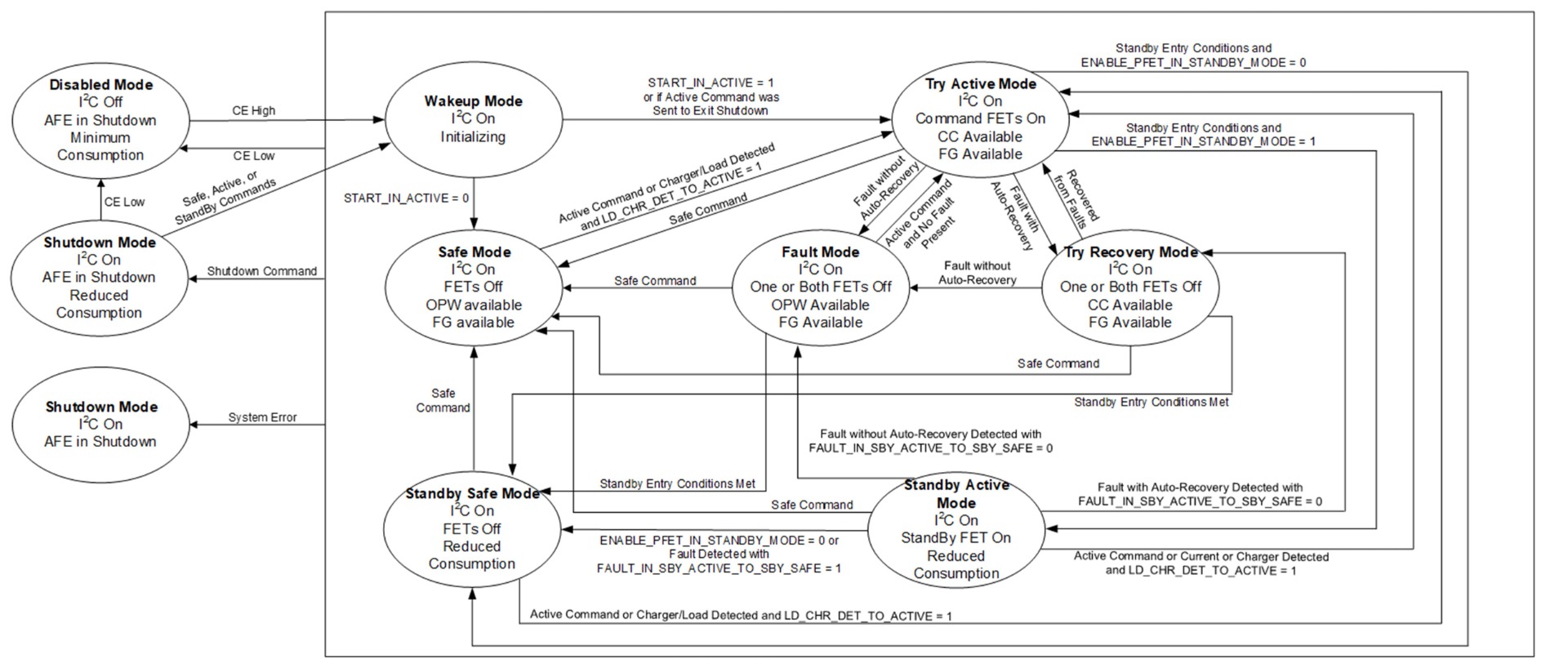

Controller Fuel Gauge (CFG) Operating Modes
Figure 4 shows a CFG state diagram for the MPF42780. The CFG supports 10 operating modes, which can be read using the BMS_STATUS register.
Figure 4: MPF42780 State Diagram
Figure 5 shows a CFG state diagram for the MPF42781.
Figure 5: MPF42781 State Diagram
The following sections explain the operating modes. See the device’s datasheet for more details regarding the related registers.
Wake Up
The wake-up state is a temporary state before device initialization concludes. While in this state, the protection MOSFETs stay open. The START_IN_ACTIVE register defines the target state when initialization is complete. If START_IN_ACTIVE=0 at the end of initialization, the operating mode is safe mode; if START_IN_ACTIVE=1 at the end of initialization, the CFG attempts to enter try active mode.
The related registers are BMS_STATUS and START_IN_ACTIVE.
Safe
In safe mode, the CFG commands the battery monitor to keep the protection MOSFETs open, which keeps the battery in a safe state. The SAFE_MODE_CMD register can be sent to the CFG to enter safe mode. If the previous state was either the try recovery state or fault state, the CFG attempts to clear the faults while transitioning to safe mode. In safe mode, short-circuit (SC) and over-current (OC) monitoring can be enabled via ENABLE_SCOC _SAFE register. In this mode, the device can read the SAFE bit to check whether the MP279x if is in safe state.
The related registers are BMS_STATUS, SAFE_MODE_CMD, SAFE, SAFE_FLAG, and ENABLE_SCOC_SAFE.
Try Active
In try active mode, the CFG attempts to close the AFE’s protection MOSFETs when there is no fault. The ACTIVE_MODE_CMD command can be sent to the CFG to attempt reaching try active mode, even if the previous state was the fault state; the CFG attempts to clear the faults to enter try active mode. In this mode, the device can read the ACTIVE bit to confirm whether the AFE is in the active/normal B state.
The related registers are BMS_STATUS, ACTIVE_MODE_CMD, ACTIVE, and ACTIVE_FLAG.
Try Recovery
Try recovery mode occurs when the CFG or AFE has noticed one or multiple fault conditions, but all the present fault conditions have auto-recovery enabled. The applicable protection MOSFET(s) open until the faults can be cleared, and then the IC attempts to reach try active mode.
The related registers are BMS_STATUS, BMS_ALARMS, BMS_RT_ALARMS, FAULTS_EN, FAULTS_REC_EN, FAULTS_1FET_EN (for the MPF42780), and FAULTS_2FET_EN (for the MPF42781).
Fault
Fault mode occurs if the CFG or AFE have detected one or multiple fault conditions that do not have auto-recovery enabled. The applicable protection MOSFET(s) are open. The faults must be manually cleared to exit this mode. In this mode, the device can read the FAULT bit to confirm whether the AFE is in a fault/normal C state.
The related registers are BMS_STATUS, FAULT, BMS_ALARMS, BMS_RT_ALARMS, FAULTS_EN, FAULTS_REC_EN, FAULTS_1FET_EN (for the MPF42780), and FAULTS_2FET_EN (for the MPF42781).
Standby Safe
Standby safe mode is similar to safe mode, but it has reduced power consumption. The fuel gauge algorithm is disabled, the high-resolution (HR) scans from the AFE are requested only every 3s, and the CFG reverts to the sleep power-saving state when there is no action to perform. The CFG can enter standby safe mode either via the STANDBY_MODE_CMD command or automatically, if the automatic standby safe mode entry conditions are met.
The related registers are BMS_STATUS, STANDBY_MODE_CMD, ENABLE_AUTOSBY, TIME_TO_STANDBY, STANDBY_CURRENT_THRESHOLD, AUTOSBY_FROM_ACTIVE, ENABLE_PFET_IN_STANDBY_MODE (for the MPF42780), ENABLE_NFET_IN_STANDBY_MODE (for the MPF42781), FAULT_IN_SBY_ACTIVE_TO_SBY_SAFE, AUTOSBY_FROM_FAULT, and AUTOSBY_FROM_RECOVERY.
Standby Active
For the MPF42780, standby active mode differs from standby safe mode, as the AFE protection MOSFETs are open but the standby discharge (SBYDSG) MOSFET is closed. For the MPF42781, this mode differs from the standby safe mode because it keeps the protection MOSFETs closed. If the AFE measures the current outside of the standby range, or if a charger is detected for the MPF42780, the device automatically exits this mode and returns to the try active mode.
Entering this mode can only be done from try active mode if the ENABLE_NFET_IN_STANDBY_MODE bit=1 and either the STANDBY_MODE_CMD command is received, or if the automatic standby entry conditions are met.
The related registers are BMS_STATUS, STANDBY_MODE_CMD, ENABLE_AUTOSBY, TIME_TO_STANDBY, STANDBY_CURRENT_THRESHOLD, AUTOSBY_FROM_ACTIVE, ENABLE_PFET_IN_STANDBY_MODE (for the MPF42780), ENABLE_NFET_IN_STANDBY_MODE (for the MPF42781), and FAULT_IN_SBY_ACTIVE_TO_SBY_SAFE.
Shutdown
In shutdown mode, the AFE is commanded into a shutdown state and the CFG reverts to the sleep state. In this mode, the protection MOSFETs are kept open, the FG is disabled, and the battery parameters are not monitored. The CFG target I2C remains available while in shutdown mode, and can be used to transition to a different mode.
The related registers are BMS_STATUS, SHUTDOWN_MODE_CMD, and SHUTDOWN_FLAG.
Disabled
Similar to shutdown mode, in disabled mode, the AFE is commanded into shutdown, the protection MOSFETs are kept open, the fuel gauge is disabled, and there is no monitoring of the battery parameters. However, the target I2C is not available in disabled mode, and the CFG is disabled. Disabled mode is achieved by setting the CE pin low. There is no related I2C register.
System Error
System error mode is only achieved when there is a loss of communication with the AFE or some other unexpected system behavior. The only way to exit this mode is by a reset, either via toggling the nRST pin, cycling the power supply, or the IC_RST_CMD command; in addition, in system error mode, SAFE_MODE_CMD register and ACTIVE_MODE_CMD register also generate a reset.
The related registers are BMS_STATUS, SYSTEM_ERROR_RT, SYSTEM_ERROR, IC_RST_CMD, SAFE_MODE_CMD, and ACTIVE_MODE_CMD.

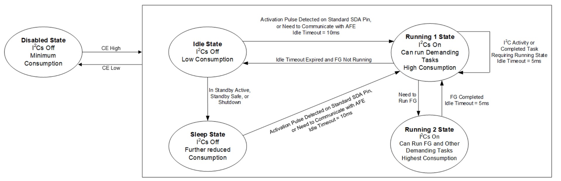

Controller Fuel Gauge (CFG) Power States
During operation, MPS’s CFGs switch between different power states depending on what the device must do (see Figure 6). Whenever possible, the CFG reverts to the power state with lowest current consumption to minimize current drawn from the battery.
Figure 6: MPF42780/81 Power States Diagram
The power states are described below.
Running States
When the CFG must perform a demanding task, it transitions to one of the running states to successfully complete these tasks.
The running 2 state achieves the maximum internal computing speed and is used during initialization, storing fuel gauge configurations to the non-volatile memory (NVM), and while running the fuel gauge algorithm.
The running 1 state achieves enough processing capability to successfully communicate through the I2C ports. This state is used when the running 2 state is not needed but communication is required with either the AFE or through the target I2C.
Idle State
To reduce current consumption when no demanding task is required, the MPF42781 reverts to an idle state with much lower current consumption compared to the running states.
Sleep State
When in shutdown or in any of the standby modes, the sleep state takes priority over the idle state for further reduced current consumption.
Disabled State
When CE is low, the CFG is in the disabled state to achieve the lowest possible current consumption.

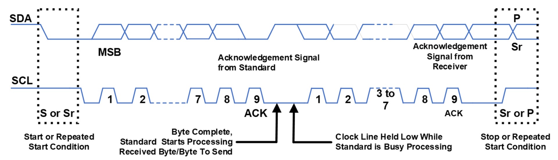

Clock Stretching
A target I2C cannot receive or transmit a complete byte of data while performing other tasks, but it can hold the SCL line low to force the initiator I2C into a wait state (clock stretching) after the 9th pulse. Then, when the target I2C is ready, data transfer continues, and the clock line (SCL) is released (see Figure 7).
Figure 7: Clock Stretching in the I2C

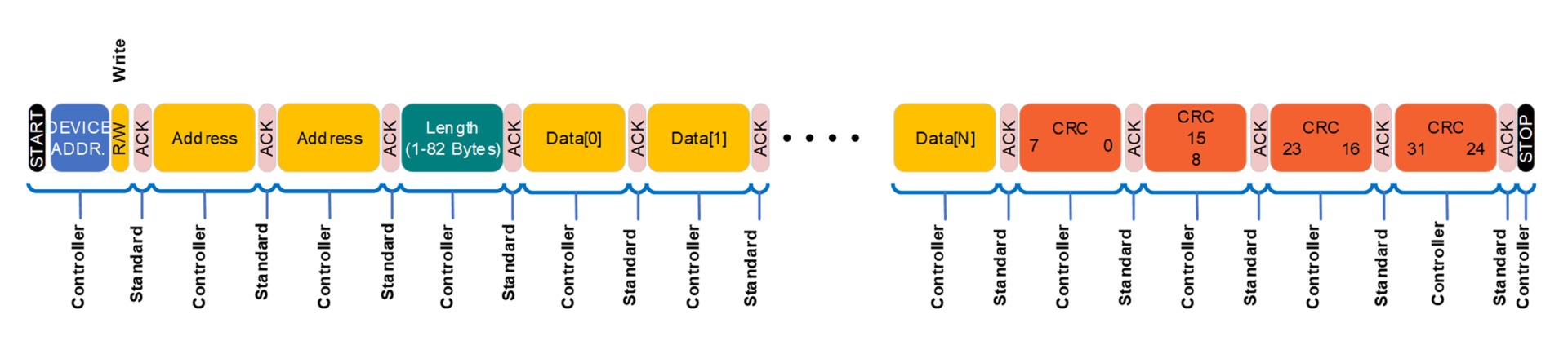

I2C Write Transaction
An I2C write transaction with an MPS fuel gauge includes the target I2C address byte with the R/W bit set to 0 (write), 2 bytes containing the 16-bit register address, a byte indicating the length in bytes of data to be written, the data bytes themselves and, if enabled, 4 CRC bytes (see Figure 8).
The process to write 0x09C4 (2 bytes: 0xC4, 0x09) to register 0x10C3 is described below.
  1. The initiator I2C pulls SDA low for 1ms to 6ms.
  2. For the start of the low pulse, wait for >5ms and <13ms (for the CFG) or <23ms (for the SFG).
  3. The initiator I2C sends a start command. The target I2C address byte + write (0x10 if I2C_ADDRESS=0x08) and check whether the fuel gauge acknowledges the command (FG ACK) (this means the fuel gauge is in active/running mode).
  4. Write to the register address byte (0x10C3), write 0xC3 and check the FG ACK, then write 0x10 and check FG ACK.
  5. For this step and all steps below, ensure that new bytes are sent sooner than 5ms from the previous byte.
  6. Write the length of the data (0x02) and check FG ACK.
  7. Write Data 0 -byte/bits[7:0] (0xC4) and check FG ACK.
  8. Write Data 1 -byte/bits[15:8] (0x09) and check FG ACK.
  9. If CRC is disabled, proceed to step 13. If CRC is enabled, the correct 4 CRC bytes must be sent for the write to be accepted. This sequence results in CRC = 0x5385D9AD.
  10. Write CRC Byte 0, bits[7:0] (0xAD) and check FG ACK.
  11. Write CRC Byte 1, bits[15:8] (0xD9) and check FG ACK.
  12. Write CRC Byte 2, bits[23:16] (0x85) and check FG ACK.
  13. Write CRC Byte 3, bits[31:24] (0x53) and check FG ACK.
  14. The initiator I2C can now send a stop command to end the transmission or repeated start command to start a new transmission.
Figure 8: I2C Write Transaction with CRC

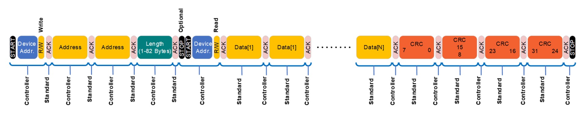

I2C Read Transaction
An I2C read transaction with an MPS fuel gauge includes the target I2C address byte with the R/W bit set to 0 (write), 2 bytes containing the 16-bit register address, a byte indicating the length in bytes of data to be read, then a stop + start or repeated start, a second target I2C Address Byte (but with the R/W bit set to 1 (read) to start reading), the data bytes being sent from the fuel gauge and, if enabled, 4 CRC bytes (see Figure 9).
The process to read 4 bytes from register 0x12C0 is described below.
  3. The initiator I2C sends a start command: target I2C address byte + write (0x10 if I2C_ADDRESS=0x08) and check FG ACK (this means the fuel gauge is in active/running mode).
  4. Write register address byte (0x12C0), write 0xC0, and check FG ACK, and then write 0x12 and check FG ACK.
  6. Write the length of the data (0x04) and check FG ACK.
  7. Send either a stop command followed by a start command or a repeated start command. Follow it with the target I2C address byte + read (0x11 if I2C_ADDRESS=0x08) and check FG ACK.
  8. Read Byte 0 and return ACK.
  9. Read Byte 1 and return ACK.
  10. Read Byte 2 and return ACK.
  11. Read Byte 3.
  12. If CRC is disabled, proceed to step 16. If CRC is enabled, continue receiving the 4 CRC bytes.
  13. Read CRC Byte 0 and return ACK.
  14. Read CRC Byte 1 and return ACK.
  15. Read CRC Byte 2 and return ACK.
  16. Read CRC Byte 3.
  17. The initiator I2C returns a NACK and can now send a stop command to end the transmission, or a repeated start command to start a new transmission.
In this example transaction, if the data bytes were {0xF4, 0x01, 0x64, 0x00}, the CRC would be 0x469B7F60. This means that the CRC bytes would have to be {0x60, 0x7F, 0x9B, 0x46} to ensure integrity on the transmission.
Figure 9: I2C Read Transaction with CRC

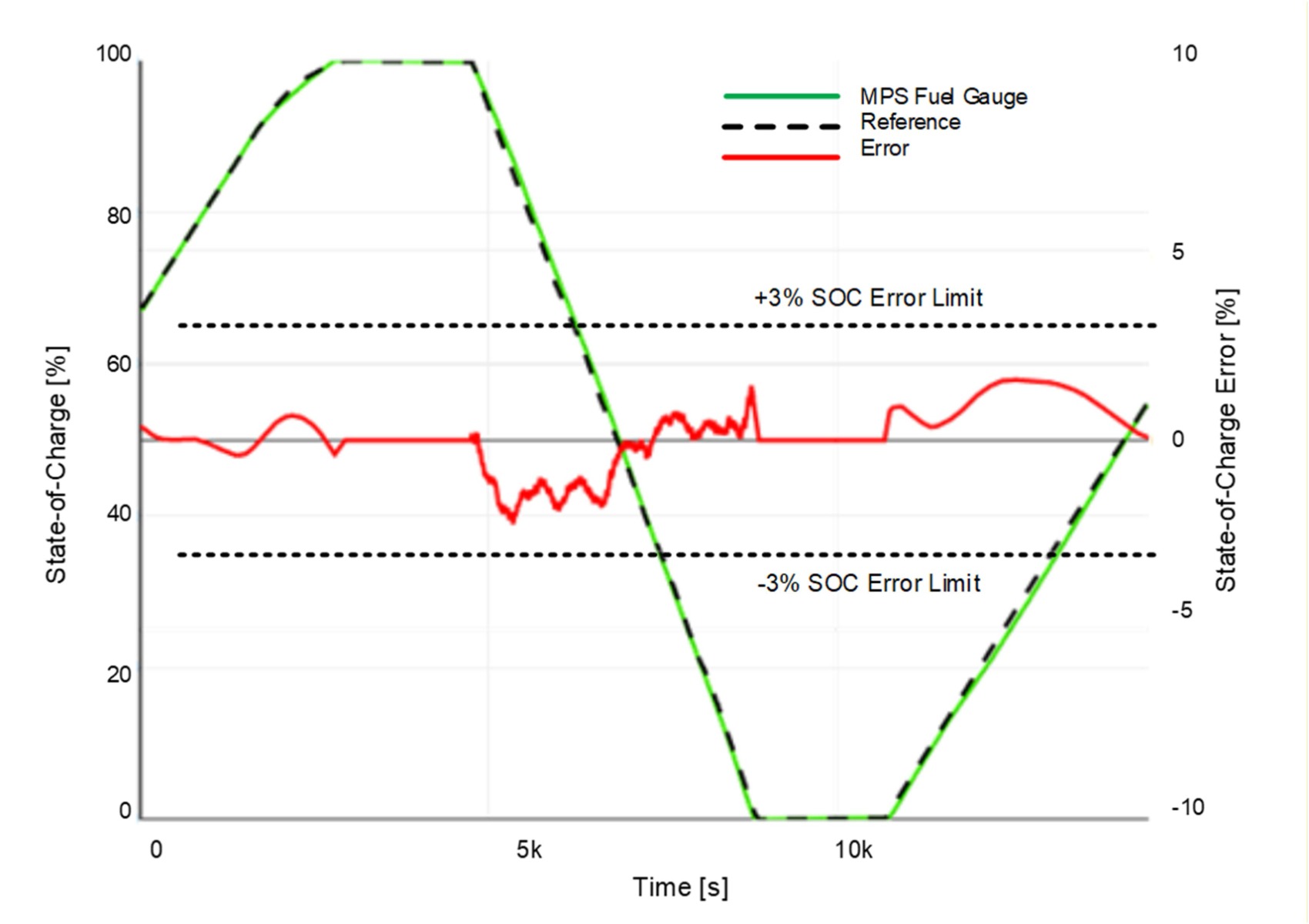

Fuel Gauge Algorithm (Both SFG/CFG)
MPS’s fuel gauges use a mix-model state-of-charge (SOC) algorithm to calculate the cell/pack SOC. Compared to the common open-circuit voltage (OCV) method or the Coulomb counter method, the MPS fuel gauge can provide accurate SOC results under transient circumstances and does not need full charge and discharge cycles to update the fully charged capacity. This fuel gauge model reduces Coulomb counting accumulation errors. For some specific applications that do not have a chance to reach full charge or full discharge, MPS’s fuel gauges achieve excellent SOC results without calibration.
This section of the application note focuses on the registers related to the FG algorithm and how to use them. Readers will understand the definition of these registers and how these registers work if they change the default value.
Some registers show under expert mode in the GUI. These sections can be related to the CFG or SFG.
A fuel gauge iteration in which the SOC is calculated follows the procedure below:
  1. Obtain the readings. The readings below should be obtained from the AFE.
    • Cell and pack voltage. If the pack voltage cannot be provided, disable the pack voltage reading (VRDG_PACK_EN bit).
    • Cell and pack current. If the cell current cannot be provided, disable cell current reading (IRDG_CELLS_EN bit).
    • Temperature points.
    • Coulomb counting. If Coulomb counting cannot be provided, disable Coulomb counting (CCRDG_EN bit).
For an SFG, the user must send this measurement data to the fuel gaugeon each fuel gauge iteration to ensure correct operation. For a CFG, the CFG triggers a high-resolution scan every 500ms to obtain all measurements needed for fuel gauging and complete battery monitoring.
  1. Update the learning parameters if the conditions are satisfied.
  2. Update the SOC state.
  3. Update the start-of-health (SOH) state and SOH learning.
  4. Update the state-of-power.
  5. Check for possible warnings.
  6. Store the results.
  7. End the iteration.
    • At this point, the fuel gauge is ready to send the fuel gauge output.
    • If enabled, the fuel gauge pulls the IRQ pin low.

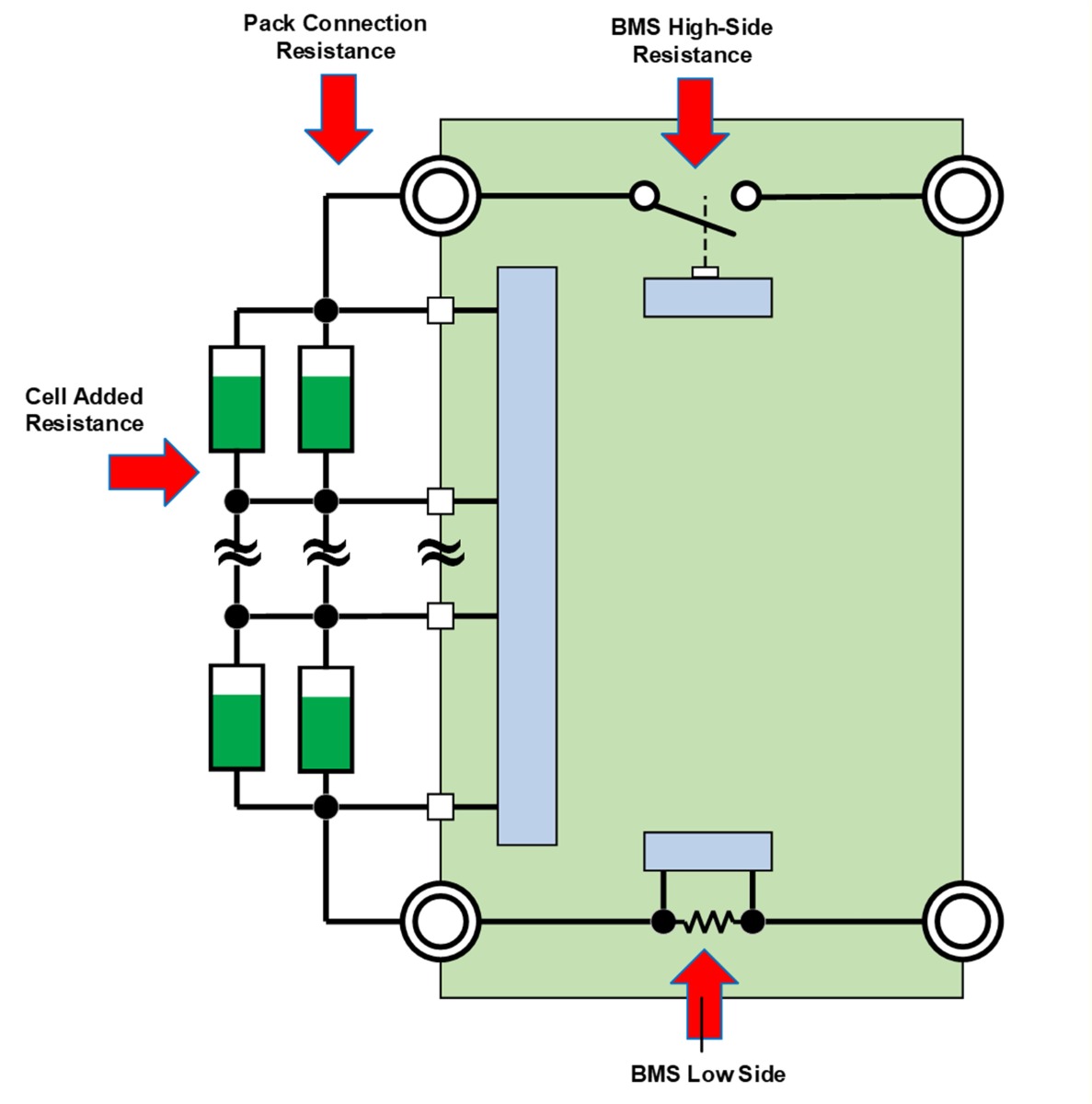

Battery Pack Configuration
The number of series cells (NCELLS_SER register) sets the number of series cells for the whole pack and affects the battery pack voltage.
The number of parallel cells (NCELLS_PAR register) sets the number of parallel cells for the whole pack and affects the battery pack capacity.
The number of temperature sensors (NTSS register) sets the total number of NTCs used within the battery pack. When matching to an MPS AFE, this number should match the setting of cell monitor NTCs (NUM_OF_CELL_NTCS register).

Added Resistance
Due to wire or bus-bar connection reasons, there is some resistance between two connected cells. Similarly, there is also some resistance in the battery management system (BMS) board. This resistance causes errors in the cell/pack voltage monitoring, which affects SOC accuracy. An MPS fuel gauge provides registers for resistance values to compensate for these voltage drops and improve SOC accuracy. Figure 10 shows a diagram for these resistances.
Figure 10: Resistances in the Battery
The pack connection resistance (RCXN_PACK register) is the resistance from the battery outputs to the BMS board. It comprises the resistance of both positive and negative wires/connections.
The BMS high-side resistance (RBMS_HSIDE register) is the total resistance at the BMS high side due to PCB traces and protection FETs.
The BMS low-side resistance (RBMS_LSIDE register) is the total resistance at the BMS low side due to shunt resistance and PCB tracing.
The cell added resistance (RCXN_CELLX register) is the resistance due to the cell-to-cell connection or any bus-bar between cells.
The fuel gauge’s GUI provides two methods to include cell-added resistance. It can be introduced as a single value for all cells in the battery packs, or as individual values for each cell in the battery pack. If the user cannot measure these values, the default configuration can be used.

Performance Evaluation
Below is an example to evaluate the pack SOC performance. This process be used during development by drawing the ideal pack SOC curve in a test that goes either from 0% to 100% or from 100% to 0%. By knowing where the curve should start and end, one can calculate the capacity added to or removed from the battery during this time to draw the ideal curve between the start and end points.
  1. After the test, extract the log data from the fuel gauge. Read the CCRDG register. Add a column (accumulated capacity) that sums all the previous CCRDG values up to the current row to obtain the capacity added to or removed from battery up to that row.
  2. The last value of the new row defines the total test capacity.
  3. The discharge reference SOC (in%) can be calculated with Equation (1):
  4. Discharge Reference SOC = 100 x (1 - (Accumulated Capacity[X] / Total Test Capacity))
    The charge reference SOC (in %) can be estimated with Equation (2):
    Charge Reference SOC = 100 x (Accumulated Capacity[X] / Total Test Capacity)
  5. The SOC Error = (Pack SOC - Reference SOC).
Figure 11 shows a reference for SOC evaluation.
Figure 11: SOC Evaluation Reference
The fuel gauge not only supports a high-accuracy SOC calculation, but it also supports cell degradation predictions, run time estimations, available power estimations, and ESR updates. The fuel gauge can also be used to determine appropriate battery protection functions within the AFE, as well as to control balancing strategies. In summary, the MPS FG can provide an all-in-one solution and help users ease their development process and MCU resource. Contact an MPS FAE for additional information.
