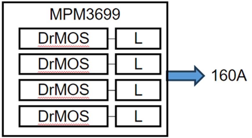

The MPM3699 is designed with four internal DrMOS modules, allowing it to produce up to 160A of IOUT. Figure 3 shows the MPM3699’s internal set-up.
Figure 3: MPM3699 Internal Set-Up
