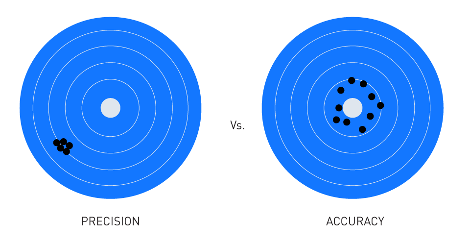

Accuracy vs. Precision and their Importance
The degree to which a measured value resembles the actual or accepted reference value is referred to as accuracy. What matters is "hitting the target." Measurements from an accurate sensor are generally quite near to the true value.
Contrarily, precision is associated with measurement repeatability. It explains the variance that appears while measuring the same component or parameter more than once. Even when a precise sensor is far from the true value, it can reliably produce the same measurement, hence it may not always be accurate.
It is impossible to exaggerate the significance of these concepts, particularly in engineering applications. Measurements taken with a sensor that is accurate but not exact can have a wide range of accuracy. On the other hand, a highly accurate yet imprecise sensor consistently produces measurements that are off. Both precision and accuracy are desired qualities in many applications to guarantee accurate and consistent measurements.
Figure 1: Precision vs. Accuracy

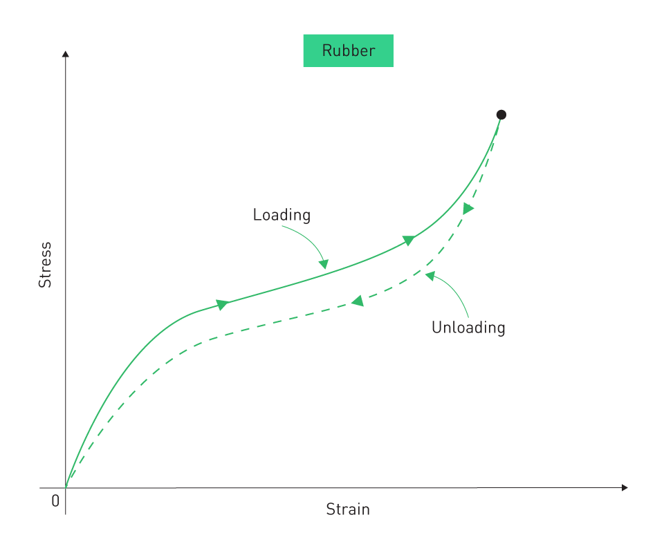

Explanation and Causes
When a particular input level is approached, hysteresis in the context of sensors is the difference in output that occurs from first increasing the input from a lower value and then decreasing it from a higher one. Consider the following situation: if you gradually increase pressure on a pressure sensor from 0 to 100 units, the reading may vary when you decrease pressure back from 100 units to the same intermediate value. Hysteresis is the term used to describe this difference or lag in response.
Figure 2: Hysteresis
A number of things can cause sensors to hysteresis:
Material Memory: Some materials for sensors, especially those with elastomeric and partially magnetic properties, have molecular configurations that cause them to "remember" their past states by nature. It is possible that they will not immediately return to their initial state when exposed to new environments.
Mechanical Friction or Stiction: Hysteresis can be brought on by internal friction in sensors that have moving components. Output readings lag as a result of this friction, which makes it difficult to react to changes quickly.
Thermal Effects: In particular, if the sensor isn't given enough time to establish thermal equilibrium, temperature variations might alter the material's properties and cause a lag or delay in response.

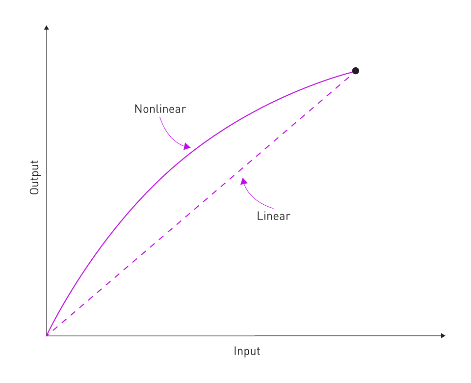

Explanation of Sensor Linearity
If the output of a sensor varies proportionately with a change in the measured amount within its designated range, the sensor is said to be linear. When the sensor's output is plotted against the measured quantity, the resultant graphic would be a straight line. The sensor's sensitivity should ideally increase with the steepness of this line (slope).
Nonlinearity shows how a sensor's actual response deviates from its predicted linear response. It represents the maximum deviation between the actual and linear responses of the sensor over its operating range and is commonly stated as a percentage of full scale (%FS).
Figure 3: Linear vs. Nonlinear Response
Perfect linearity is uncommon in real-world settings. Sensors are usually non-linear to some extent, although in many cases, this non-linearity is so small as to be insignificant.

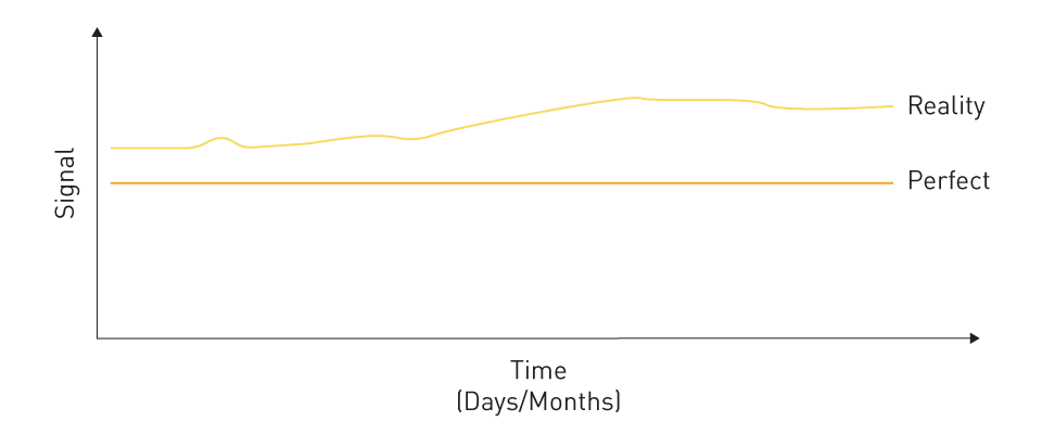

Cause of Sensor Drift
Drift describes an unwanted shift in sensor output when the input doesn't change. Instead of occurring suddenly, this variation is usually noticed over long periods of time and might be attributed to age, environmental variables, or intrinsic properties of the sensor materials.
Figure 4: Signal Drift
