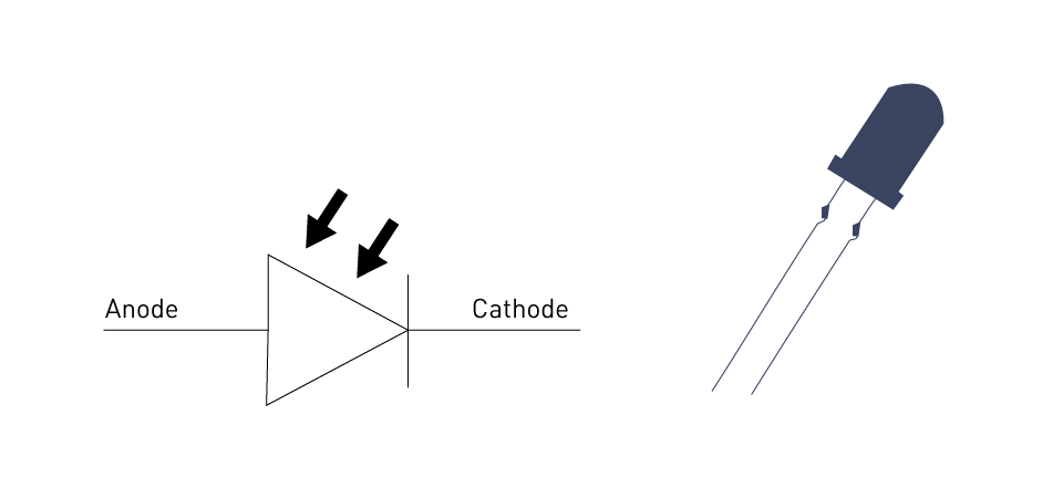

Photodiodes
One essential element in the range of optical sensors are photodiodes, which function as transducers to transform light into electrical current. Their great sensitivity and quick response are well known, and these are crucial characteristics that help with applications like Light Detection and Ranging (LIDAR).
Figure 1: A Photodiode

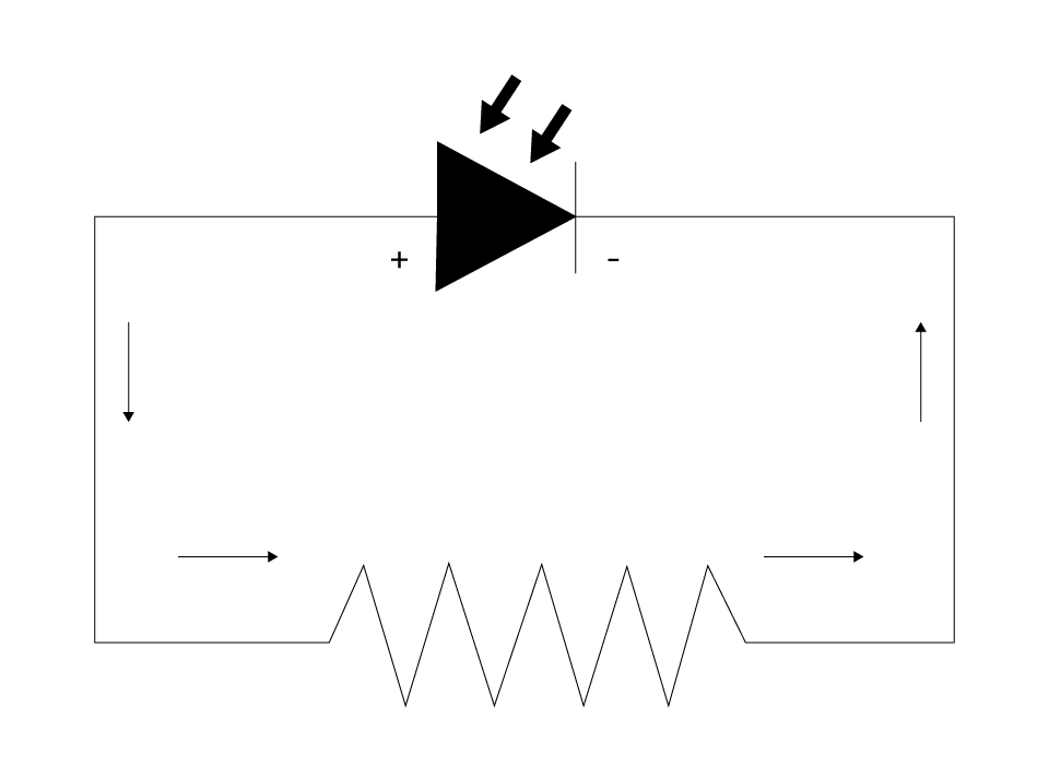

Working Principle
The basis of photodiodes' operation is photon absorption, which creates electron-hole pairs in semiconductor materials. When photons, which are the building blocks of light, hit the photodiode, they provide electrons enough energy to break free from their atomic orbits and produce matching holes. Quantification of light levels is made possible by the passage of these electron-hole pairs, which form an electric current that is directly proportional to the intensity of the incident light.
Figure 2: Working of a Photodiode

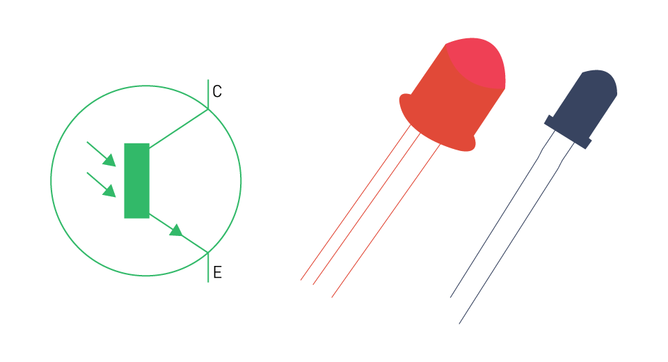

Phototransistors
In optical sensing technology, phototransistors are essential components that perform as both photodiodes and bipolar junction transistors (BJTs). Signal processing and communication are just two of the advanced applications that phototransistors can be used for. They stand out for their increased sensitivity and magnified reaction to light.
Figure 3: A Phototransistor
Amplified Response Compared to Photodiodes
While phototransistors and photodiodes function according to comparable principles, their reactions to incident light differ considerably. Whereas phototransistors amplify this current to provide a greater output signal, photodiodes directly convert light into current. Compared to conventional photodiodes, this amplification is made possible by the intrinsic gain of the transistor, which allows for the detection of lower light levels. Because of their built-in amplification, phototransistors can operate efficiently in low-light situations, which increases their dependability and expands their potential applications.

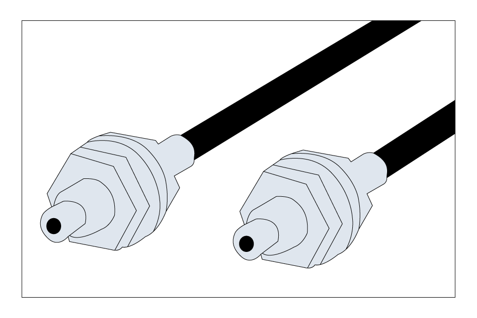

Fiber Optic Sensors
Fiber optic sensors are the pinnacle of adaptable, cutting-edge sensing devices that use the characteristics of light to measure a variety of parameters like strain, pressure, and temperature. These sensors are ideal in many difficult applications because of their high sensitivity, small design, and resilience to electromagnetic interference when combined with optical fibers.
Figure 4: Fiber Optic Sensors

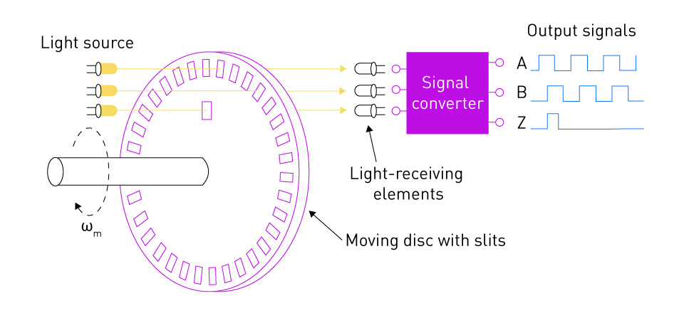

Figure 5: Optical Encoder
Principles of Operation: Optical Detection of Rotary Position
The basis of operation for optical encoders involves adjusting light intensity via an encoder wheel, which is a patterned disk attached to a spinning body. One side of the disc has a light source, often an LED, while the other side has a photodetector. The encoder wheel disrupts the light beam as the item spins, producing a sequence of light pulses that are subsequently picked up and translated into electrical signals. Accurate and real-time monitoring of the rotational parameters is made possible by the direct correlation between the number and frequency of the pulses and the angular position, speed, and direction of rotation.
Figure 6: Working of an Optical Encoder
Incremental vs. Absolute Encoders
Incremental Encoders: Pulse streams corresponding to the object's incremental displacement are produced by incremental optical encoders. They need a reference point in order to calculate absolute position because they do not store positional information. Because of their simplicity and cheaper cost, incremental encoders are useful for measuring both speed and direction.
Absolute Encoders: As opposed to this, absolute optical encoders provide each rotational position a distinct output code, making it possible to determine the precise location without the use of a reference point as soon as the device is powered on. Although more expensive and complex than incremental encoders, this is essential in situations where knowing the precise location is critical, including robotics and industrial automation.
