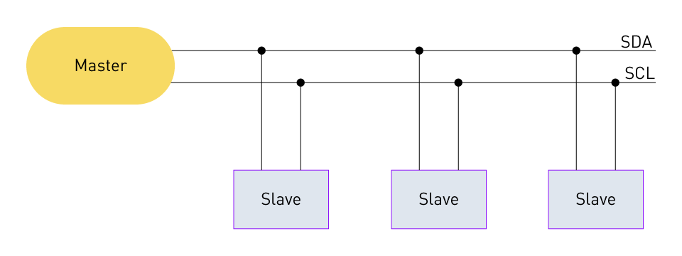

Inter-Integrated Circuit (I2C): I2C is a widely adopted, synchronous, multi-master/multi-slave, packet-switched, single-ended, serial communication bus. It is advantageous for its simplicity, requiring only two bidirectional open-drain lines (SDA for data and SCL for clock), and its support for multiple devices on the same bus. Its scalability and flexibility make it suitable for various applications, from simple connections to complex networks, but it may be less optimal for high-speed or long-distance communications due to its susceptibility to signal degradation.
Figure 1: I2C wire layout

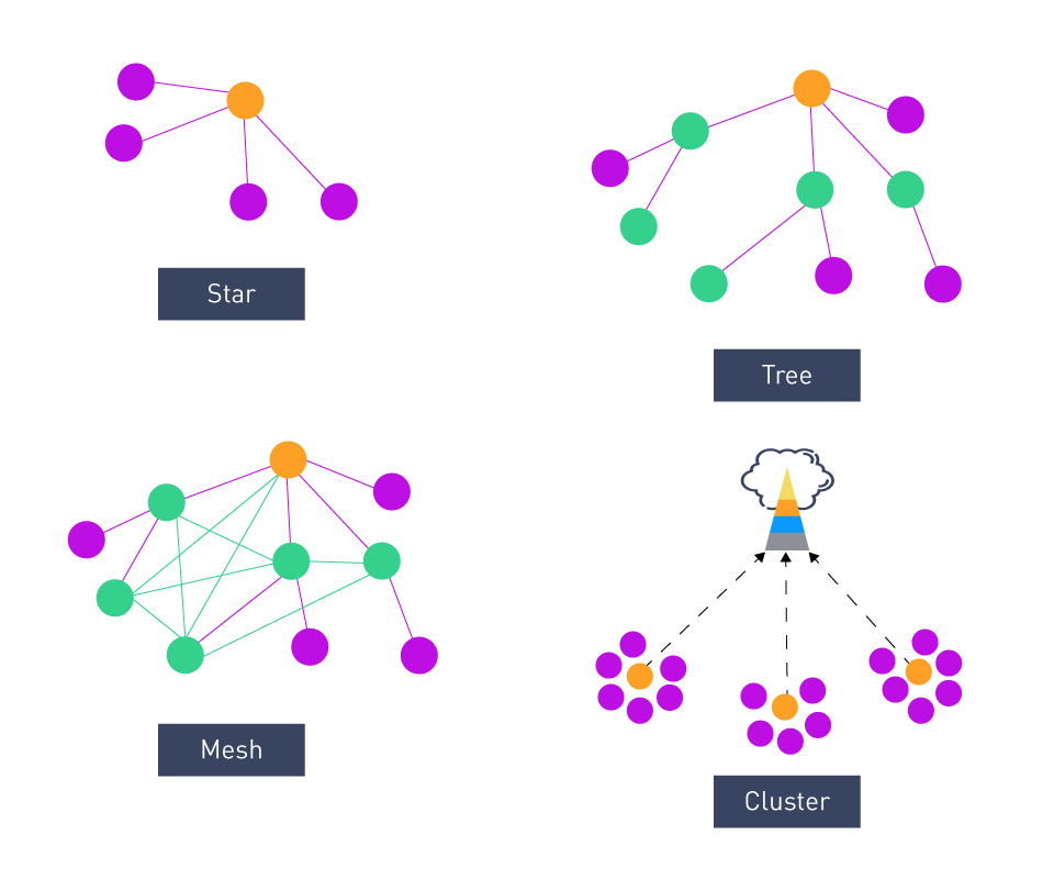

The way sensors are organized and communicate with each other in a network is governed by its topology. Some common topologies include:
Star Topology: Each sensor (or node) communicates directly with a central node. It's simple but can be bandwidth-intensive for the central node.
Mesh Topology: Sensors are interconnected, and data can take several paths to reach its destination. It offers redundancy but is more complex to set up and manage.
Tree Topology: A hierarchical structure where some sensors act as leaders or aggregators for subsets of other sensors.
Cluster-Based Topology: Nodes are grouped into clusters, with one node acting as the cluster head, aggregating and forwarding the data.
Figure 3: Sensor network topologies
Sensor networks and their communication protocols form the backbone of many modern sensing applications. By understanding the basic principles of these networks and the challenges they face, engineers can design robust, efficient, and scalable systems that leverage the power of multiple sensors to derive insights from vast swaths of data. As technology advances, the role of sensor networks will only become more prominent, underscoring the need for continued research and development in this area.
