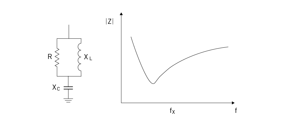

High-Pass Filters
A high-pass filter allows all frequencies above a certain cut-off frequency to pass while attenuating all frequencies below the cut-off. This type of filter consists of a series circuit with a resistor (R) and a capacitor (C). The cut-off frequency (fc) is determined by the values of R and C, given by fc = 1/(2πRC). At frequencies above the cut-off, the filter's impedance decreases, allowing the frequencies to pass. At frequencies below the cut-off, the filter's impedance increases, attenuating the frequencies. High-pass filters are useful in power systems where there are many high-order harmonics that need to be eliminated.
Figure 3 shows the circuit schematic and a typical impedance characteristic for the high-pass filter.
Figure 3: High-Pass Filter
