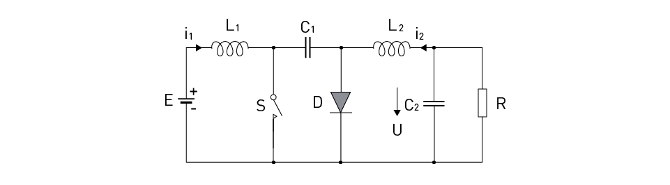

Figure 13: The Ćuk converter circuit diagram

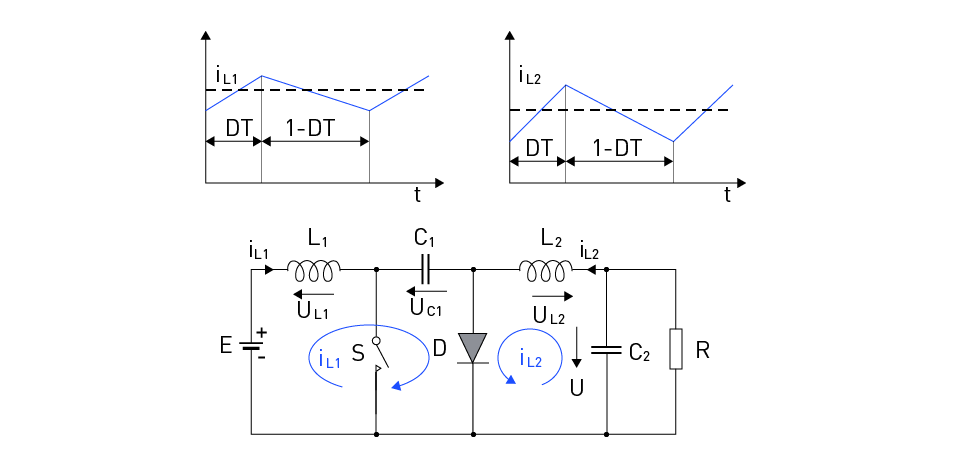

In this converter, during the tON interval (Figure 14), the switch S is turned on, inductor L1 is connected to the DC power source E, while the diode D is reverse biased with the voltage across capacitor C1. In steady-state, the average voltage across inductors is zero, so the average voltage across capacitor C1 is $$U_{C1} = U + E$$
Under the influence of voltage E, the current through inductor L1 linearly increases from the minimum to the maximum value. At the same time, inductor L2 is connected to a voltage that is equal to the difference between the load voltage and the voltage across capacitor C1, so its current also linearly increases from the minimum to the maximum value.
Figure 14: The Ćuk converter circuit diagram – interval tON

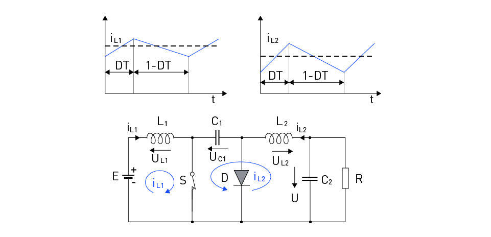

During the tOFF interval (Figure 15), when the switch S is turned off, the current through inductor L2 is closed through the diode D, connecting inductor L2 to the load voltage, so its current linearly decreases from the maximum to the minimum value. At the same time, inductor L1 is connected to a voltage that is equal to the difference between the voltage across capacitor C1 and the DC power source E, causing its current to decrease from the maximum to the minimum value.
Figure 15: The Ćuk converter circuit diagram – interval tOFF
In steady-state, the average voltage across the inductors is zero, so the average voltage across capacitor C1 is:
$$U_{C1}=U+E$$The change in the inductor current during a period T is proportional to the area of the voltage across the inductor:
$$u_L = L \frac{di_L}{dt} \Rightarrow \Delta I_L = \frac{1}{L} \int_0^T u_L dt$$In steady-state, the total change in the inductor current is zero because the average value of the voltage across the inductor is zero:
$$\Delta I_L |_{t_{ON}} = \frac{E}{L_1} \cdot T \cdot d = \Delta I_L |_{t_{OFF}} = \frac{U_{C1} - E}{L_1} \cdot T \cdot (1 - d)$$The previous equations yield:
$$U = \frac{d}{1 - d} \cdot E = E \cdot \frac{t_{ON}}{t_{OFF}}$$and this is the transfer function of the buck-boost converter.
The Ćuk converter consists of several key components arranged in a unique topology to enable its advantageous features, such as continuous input and output currents and reduced EMI. The primary components of the Ćuk converter include:
- Input source: The DC voltage source that provides the input power for the converter.
- Input inductor (L1): This inductor stores energy during the ON state and transfers it to the output during the OFF state.
- Output inductor (L2): This inductor smooths the output current, minimizing the ripple and contributing to the converter's continuous output current characteristic.
- Capacitor (C1): This capacitor facilitates energy transfer between the input and output inductors during the switching process.
- Output capacitor (C2): This capacitor filters and smooths the output voltage, providing a stable DC output to the load.
- Switch (S): Typically a MOSFET or IGBT, the switch controls the energy transfer between the input and output inductor by alternating between the ON and OFF states.
- Diode (D): This diode ensures that current flows in the correct direction during the switching process and prevents reverse current flow when the switch is in the OFF state.
The unique topology of the Ćuk converter features an LC network formed by the input inductor (L1), coupling capacitor (C1), and output inductor (L2). The input and output inductors are connected in series, and the coupling capacitor is connected between them. When the switch is closed (ON state), the input inductor stores energy and the output capacitor supplies power to the load. When the switch is opened (OFF state), the input inductor transfers its stored energy to the output capacitor through the coupling capacitor, and the output inductor smooths the output current.
