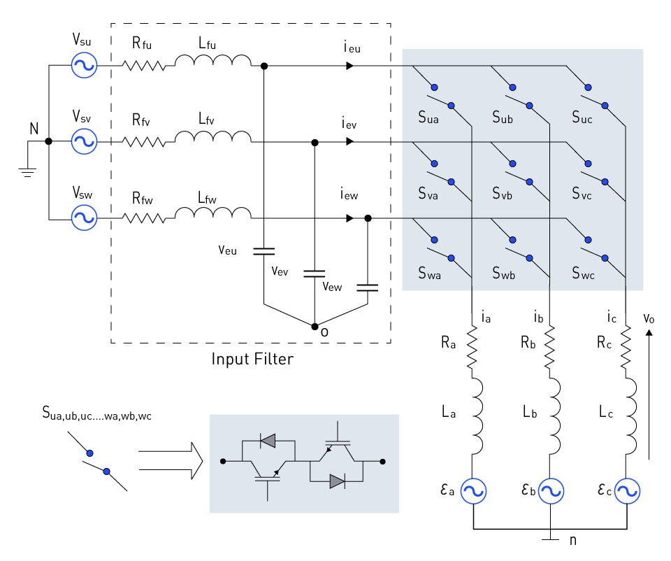

Fundamentals Of Matrix Converters
A matrix converter is made up of a matrix of bi-directional power switches that link the input and output phases. A three-phase to three-phase matrix converter includes nine bi-directional switches, each of which is commonly made up of two back-to-back linked semiconductor devices, such as IGBTs or MOSFETs, with anti-parallel diodes (Figure 7).
Figure 7: Matrix converter topology
Operation Of Matrix Converters
The matrix converter transfers power from the input phases to the output phases by selectively shutting and opening the bi-directional switches. The converter may generate an output voltage waveform with the required amplitude, frequency, and phase shift by adjusting the duty cycle and timing of the switches. The switching operation also affects the input current waveform, keeping it sinusoidal and in phase with the input voltage, resulting in a high power factor.
