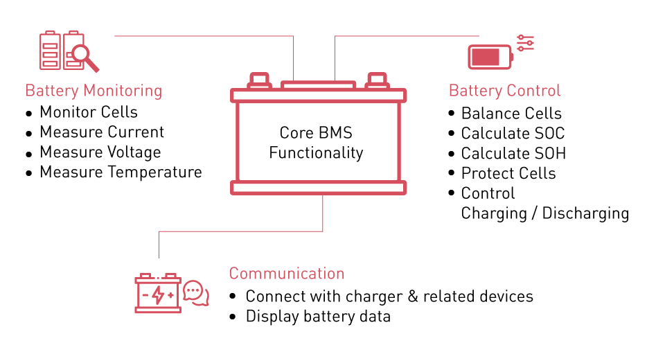

Key Function of BMS
Figure 1: BMS functionality
Battery Management System (BMS) are essential for the best performance of battery packs. They achieve this by performing a number of tasks, such as monitoring, protecting, balancing, and reporting. The performance, longevity, and safety of battery systems are all guaranteed by each of these functions.
Monitoring
A BMS's control and management operations are built on top of monitoring. It is essential to continuously monitor important variables including voltage, current, temperature, and SOC. Each cell or group of cells in the battery pack is continuously monitored by the BMS to make sure they are operating within the specified parameters. Monitoring is crucial for real-time management as well as for gathering information that may be used to forecast the battery pack's future performance and health.
Protection
One of the primary responsibilities of a Battery Management System (BMS) is to safeguard the battery and the system as a whole against conditions that could potentially cause harm or present safety hazards. The BMS carries out protective actions to counteract scenarios such as overcharging, deep discharging, overcurrent, short-circuits, and overheating. For example, if the voltage across a cell surpasses a specific threshold, indicating overcharging, the BMS may disconnect the charging circuit or divert the current to prevent further charging of that particular cell.
Balancing
Equalization is a crucial task carried out by the BMS to guarantee a uniform State of Charge (SOC) among all cells within a battery pack. In a series configuration, even slight disparities in individual cell capacities or impedance can lead to imbalances over time. Equalization can be accomplished through either passive or active methods. Passive equalization entails dissipating excess energy in the form of heat in cells with a high SOC, while active equalization involves transferring charge from cells with higher charge levels to those with lower levels. This process ensures that the battery pack can utilize its entire capacity and contributes to prolonging the overall lifespan of the battery.
Reporting
Reporting includes delivering pertinent facts and information to the user or other systems. A BMS transmits crucial data, including the SOC, SOH, and any fault circumstances, through reporting. This data can be utilized to provide data to other systems for control and decision-making, as well as to inform the user of the battery's present condition. For instance, in electric vehicles, the BMS interacts with the central control unit to provide data on the battery pack's condition, which might affect how the vehicle runs.
