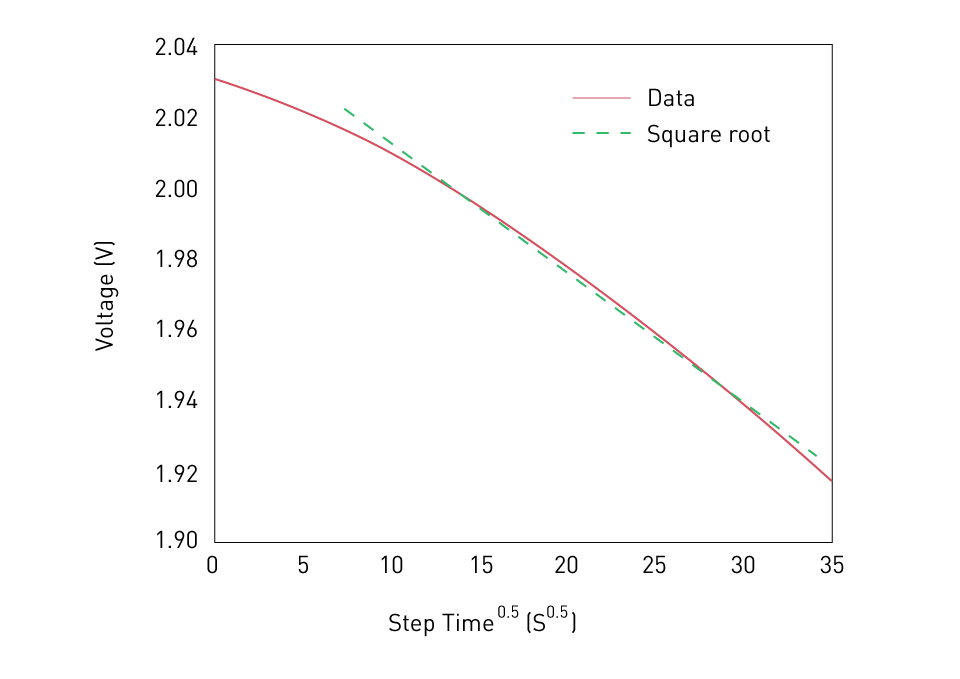

Curve Fitting: This method entails the fitting of a curve or mathematical function to a collection of experimental data points. In the context of electrochemical models, this might involve the fitting of voltage curves or concentration profiles to empirical data. Various curve-fitting techniques can be applied for this purpose. The following list, while not exhaustive, provides an overview:
- Linear fitting, with respect to the square-root of the step time

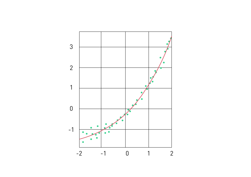

- Exponential fitting, where an exponential is fit to the experimental data

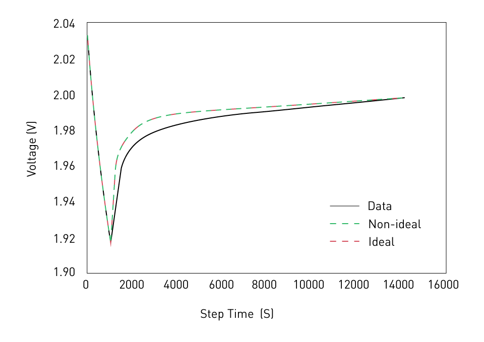

- Perform direct-pulse fitting by directly matching the voltage to a one-dimensional electrochemical model. This approach aims to replicate the same characteristics and calculate the diffusion coefficient.
Figure 10: Linear fitting method
Figure 11: Exponential fitting
Figure 12: Direct-pulse fitting

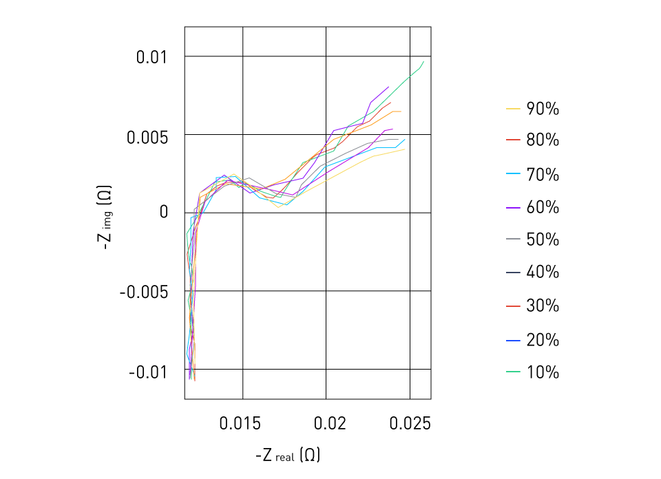

Frequency Response Analysis: The system's frequency response can be ascertained by exposing it to sinusoidal excitation signals of varied frequencies and examining the response. The electrical components in the ECM's electrical components can be estimated using this information. The Nyquist diagram is used to show the excitation's outcomes. A point on the diagram is represented by every excitation frequency. The complex impedance of the battery can be seen in the diagram varying with frequency. Going from left to right, zones of high frequency and low frequency can be distinguished. Each zone represents a separate phenomenon in the battery, such as diffusion (low frequency) and charge-transfer reaction (high frequency).
Figure 14: Nyquist plot of a battery discharge

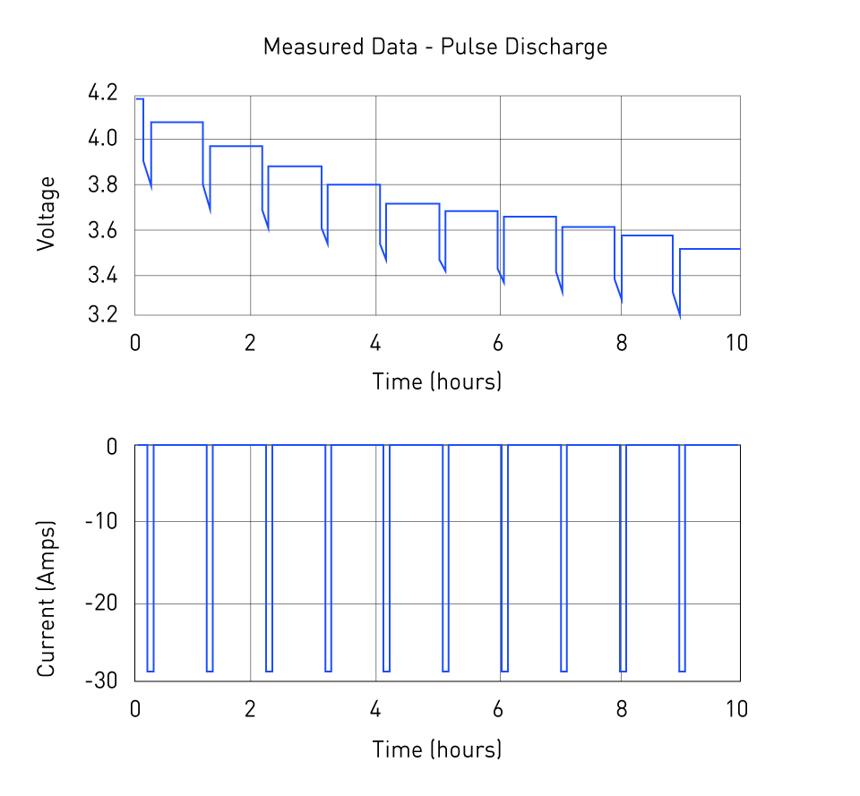

Time-Domain Methods: These techniques entail examining the system's time-domain response to particular excitation signals such as steps in the load current. One can adjust the parameters to get the best fit by comparing the measured and model-generated time-domain responses. The time-domain analysis test method used with a current pulse-stream test is shown in the following plot:
Figure 15: Pulse-stream test of battery
