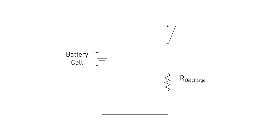

Passive Battery Balancing
Figure 2: Passive balancing
Overview And Operation Principle
Within a battery pack, the method used to equalize the charge state among individual cells is known as Passive Battery Balancing. The simplicity and cost-effectiveness are the key attributes of this technique. Through resistive parameters, passive balancing operates by releasing extra energy in cells with higher State-of-Charge (SOC), placing them in line with other cells having lower SOC.
Implementations
Bleeding Resistor: Passive Battery Balancing is commonly deployed as the bleeding resistor. A resistor is linked in parallel with each cell in this technique, and the cells having greater voltage selectively involves the resistor with the help of a control system. For equalizing the SOC with other cells, the extra energy is drained out as heat via the resistor.
Shunt Capacitor: In shunt capacitor technique, the parallel capacitors are connected with the cells and used to store energy from the greater voltage cells on temporary basis. Just like the bleeding resistor technique, this energy can then be slowly released through a resistor.
