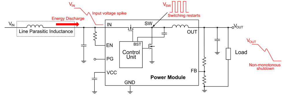

A Class R Type I shutdown occurs when the DC/DC converter restarts.
Consider a standard shutdown. If VIN drops to the chip’s turn-off threshold, the chip shuts down. VOUT drops during this process, causing the current to suddenly decrease. However, if the chip’s input line has nowhere to release the excess energy from the inductive reactance during this process, then VIN sharply increases.
If VIN exceeds the chip’s operating threshold, the chip resumes operation and results in a non-monotonous shutdown waveform. A Class R waveform is classified as Type I if there is a switch present on the SW side (see Figure 2).
Figure 2: Line Parasitic Inductance of Class R Type I Shutdown
