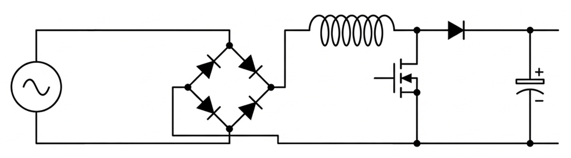

Selecting between CCM and CrM/DCM presents a fundamental tradeoff that directly impacts the converter’s efficiency, physical size, cost, and EMI performance. Figure 1 shows the typical PFC boost converter schematic.
Figure 1: Typical PFC Boost Converter Schematic

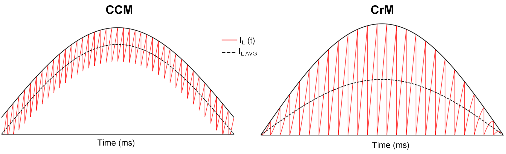

Figure 2 shows the fundamental difference between the IL waveforms of the PFC boost modes (CCM and CrM) across a few switching cycles around the peak of the line half-cycle, where the average inductor current (IL_AVG) is highest.
Figure 2: PFC Boost Modes
The IL behaviors in CCM and CrM are described below:
- CCM: IL always remains above 0A and has a relatively small triangular ripple current superimposed onto a large average inductor current (IL_AVG).
- CrM: IL is a series of triangles, where each cycle begins at 0A. The current ramps up to a peak, then ramps back down to 0A, at which point the next cycle immediately begins.

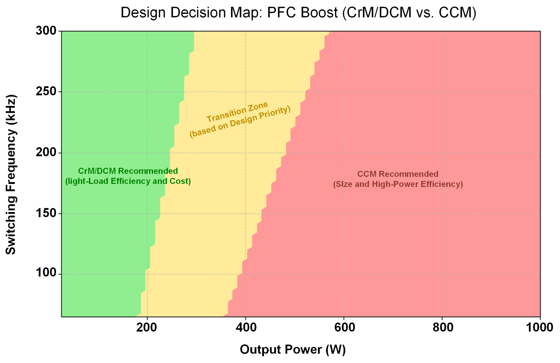

A visual decision map can be used for verification by plotting the output power (POUT) against typical switching frequencies (see Figure 3).
Figure 3: PFC Mode Design Decision Map (CrM/DCM vs. CCM)
The ideal operating regions for each mode are described below:
- CrM/DCM recommended (green region in Figure 3): As established in step 2 when analyzing the core tradeoffs, this region is ideal for CrM due to superior efficiency at light loads and lower cost.
- CCM recommended (red region in Figure 3): The lower conduction losses and smaller inductor size in CCM are ideal for high-power, high-density designs. Moreover, CCM offers advantages for conducted EMI and EMI filter designs due to its lower inductor current ripple and higher continuous input current.
- Transition zone (yellow region in Figure 3): The decision between selecting CrM/DCM and CCM depends on the primary design constraint identified in step 1.

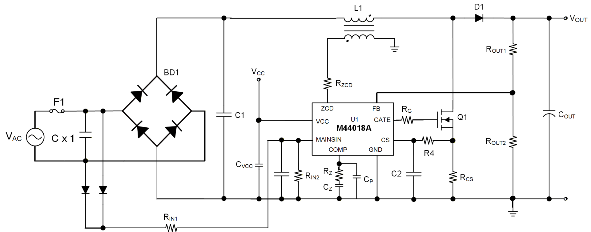

The MP44018A is employed for the power factor correction (PFC) stage as a multi-mode controller operating in CrM and DCM via the ZCD pin (see Figure 4). It is designed to provide high-performance active PFC with a minimal number of external components. This PFC controller’s very low supply current achieves low standby power loss, with a typical no-load power consumption below 30mW. Light-load efficiency is improved through dead-time extension technology, which reduces the switching frequency under such conditions. Furthermore, the MP44018A achieves lower total harmonic distortion (THD) compared to conventional constant-on-time (COT) control by utilizing a variable-on-time control strategy while in DCM.
Figure 4: CrM/DCM PFC Boost Using the MP44018A

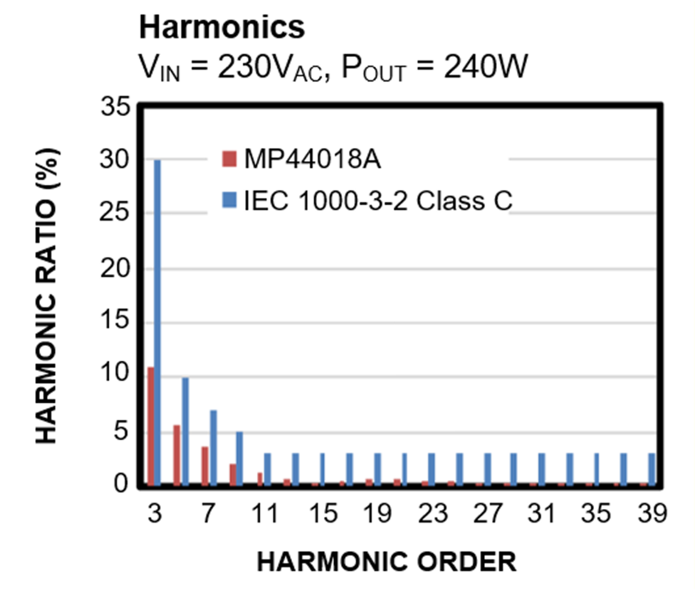

Figure 5 shows the measured input current harmonic spectrum at VIN = 230VAC and POUT = 240W in a compliance-oriented view of boost PFC performance. The red bars correspond to the harmonic content achieved by the implemented PFC solution with the MP44018A. The blue bars show the applicable IEC 61000-3-2 harmonic current limits for the target equipment class.
Figure 5: Harmonics Results Compared to IEC 1000-3-2 Class C
