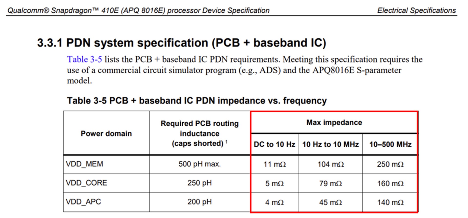

Figure 2 shows the varying target impedance across different frequency ranges, based on data from a vendor website.[1] This means every element in the power distribution must be optimized at different frequencies.

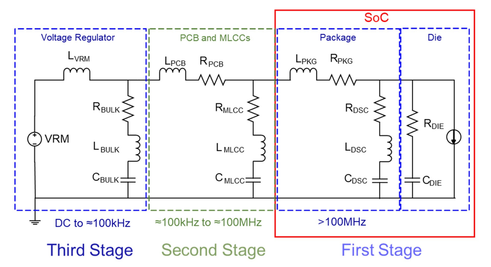

To further explore optimizing power rail design, the fundamentals of PDN design must be re-examined in addition to considering new approaches to achieve optimal performance. Figure 3 shows the PDN conceptualized as a three-stage low-pass filter, where each stage of this network plays a specific role in filtering and stabilizing the current drawn from the SoC die.
Figure 3: PDN Conceptualized as a Three-Stage Low-Pass Filter
The three-stage low-pass filter is described below:
- Current drawn from the SoC die: The process begins with current being drawn from the SoC die. Any current drawn is filtered by the package, which interacts with die-side capacitors (DSCs). This initial filtering stage reduces the current’s slew rate before it reaches the PCB socket.
- PCB layout considerations and MLCCs: Once the current passes through the PCB ball grid arrays (BGAs), the second stage of filtering occurs as the current flows through the power planes on the PCB and encounters the MLCCs. During this stage, it is crucial to focus on selecting capacitors that effectively operate at specific frequencies. High-frequency capacitors placed beneath the SoC do not significantly influence lower frequency regulation.
- Voltage regulator (VR) with power planes and bulk capacitors: The final stage involves the VR and bulk capacitors, which work together to stabilize the power supply by addressing lower-frequency noise.
The PDN’s three-stage approach ensures that each component contributes to minimizing impedance across different frequency bands. This structured methodology is vital for achieving reliable and efficient power delivery in modern electronic systems.

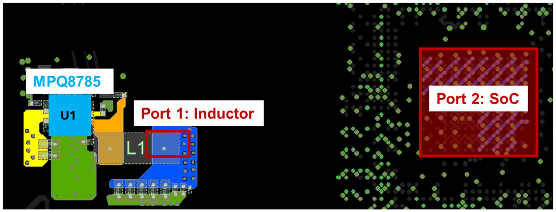

To initiate the process, PCB parasitic extraction is performed on the MPS evaluation board. Figure 4 shows a top view of the MPQ8785 evaluation board layout, where two ports are selected for analysis. Port 1 is positioned after the inductor, while Port 2 is connected to the SoC BGA.
Figure 4: MPS Telecom Evaluation Board
Capacitor models from vendor websites are also included in this layout, including the equivalent series inductance (ESL) and equivalent series resistance (ESR) parasitics. As many capacitor models as possible are allocated beneath the SoC in the bottom of the PCB to maintain a flat impedance profile.

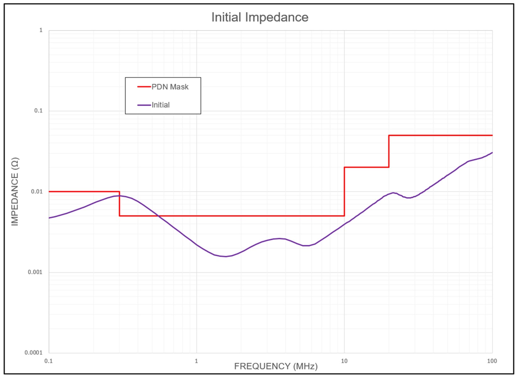

Figure 5 shows a comparison of the target impedance profile defined by the PDN mask for the core rails to the actual initial impedance measured on the MPQ8785 evaluation board using the initially selected capacitors. This graphical comparison enables a direct assessment of the impedance characteristics, facilitating the evaluation of the PDN performance.
Figure 5: Target Impedance Profile vs. Initial Impedance
Based on the data from Figure 5, the impedance exceeds the specified limit within the 300kHz to 600kHz frequency range, indicating that additional capacitance is required to mitigate this issue. Introducing additional capacitors effectively reduces the impedance in this frequency band, ensuring compliance with the specification. Notably, high-frequency capacitors are also observed to have a negligible impact on the impedance at higher frequencies, suggesting that their contribution is limited to specific frequency ranges. This insight informs optimizing capacitor selection to achieve the desired impedance profile.

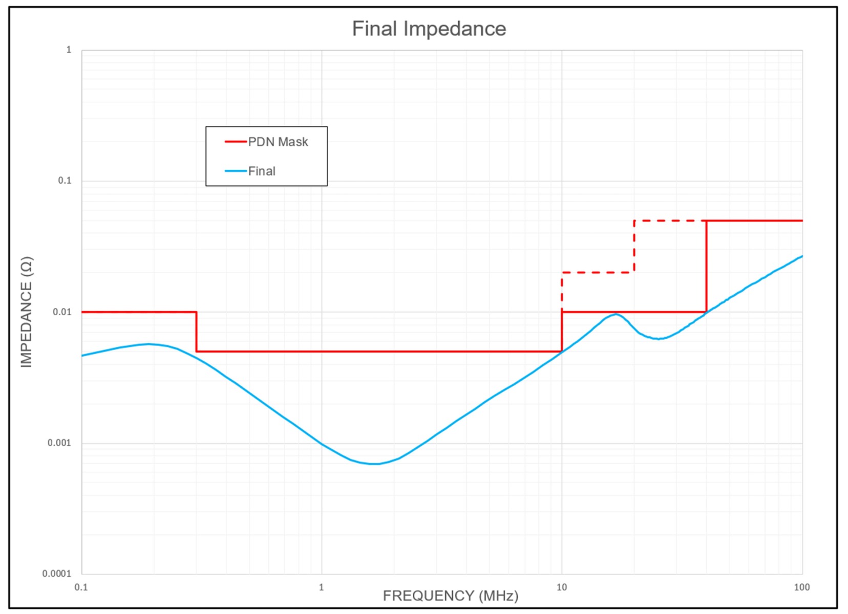

The final capacitor selection ensures that the PDN impedance profile meets the specified mask, thereby ensuring reliable power delivery and performance. Figure 6 shows the final impedance with optimized capacitance.
Figure 6: Final Impedance with Optimized Capacitance
With a sufficient margin at frequencies above 10MHz, capacitors that primarily affect higher frequencies can be eliminated. This strategic reduction minimizes the occupied area and decreases costs while maintaining compliance with all specifications. Performance, cost, and space considerations are effectively balanced by using the optimal combination of capacitors required to satisfy the impedance mask requirements, enabling robust PDN functionality across the operational frequency range.
To facilitate the case study, the impedance mask was modified within the 10MHz to 40MHz frequency range, decreasing its overall value to 10mΩ. Implementing 10 additional 0.1µF capacitors was beneficial to reduce impedance in the evaluation board, which then effectively reduced the impedance in the frequency range of interest.
Figure 7 shows the decreased impedance mask as well as the evaluation board’s impedance response. The added capacitance successfully reduces the impedance within the specified frequency range.
Figure 7: Impedance with Optimized Capacitance for Decreased PDN Mask
