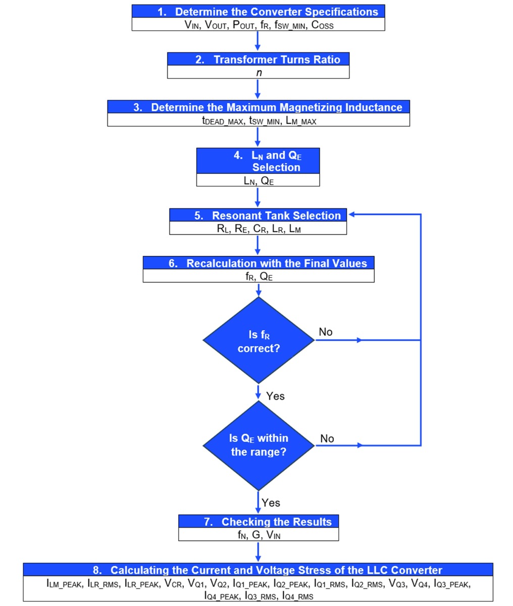

Figure 2 shows a flowchart of the meticulous step-by-step approach for designing an LLC resonant converter, which is described in further detail in the following sections.
Figure 2: Step-by-Step Flowchart for LLC Resonant Converter Design

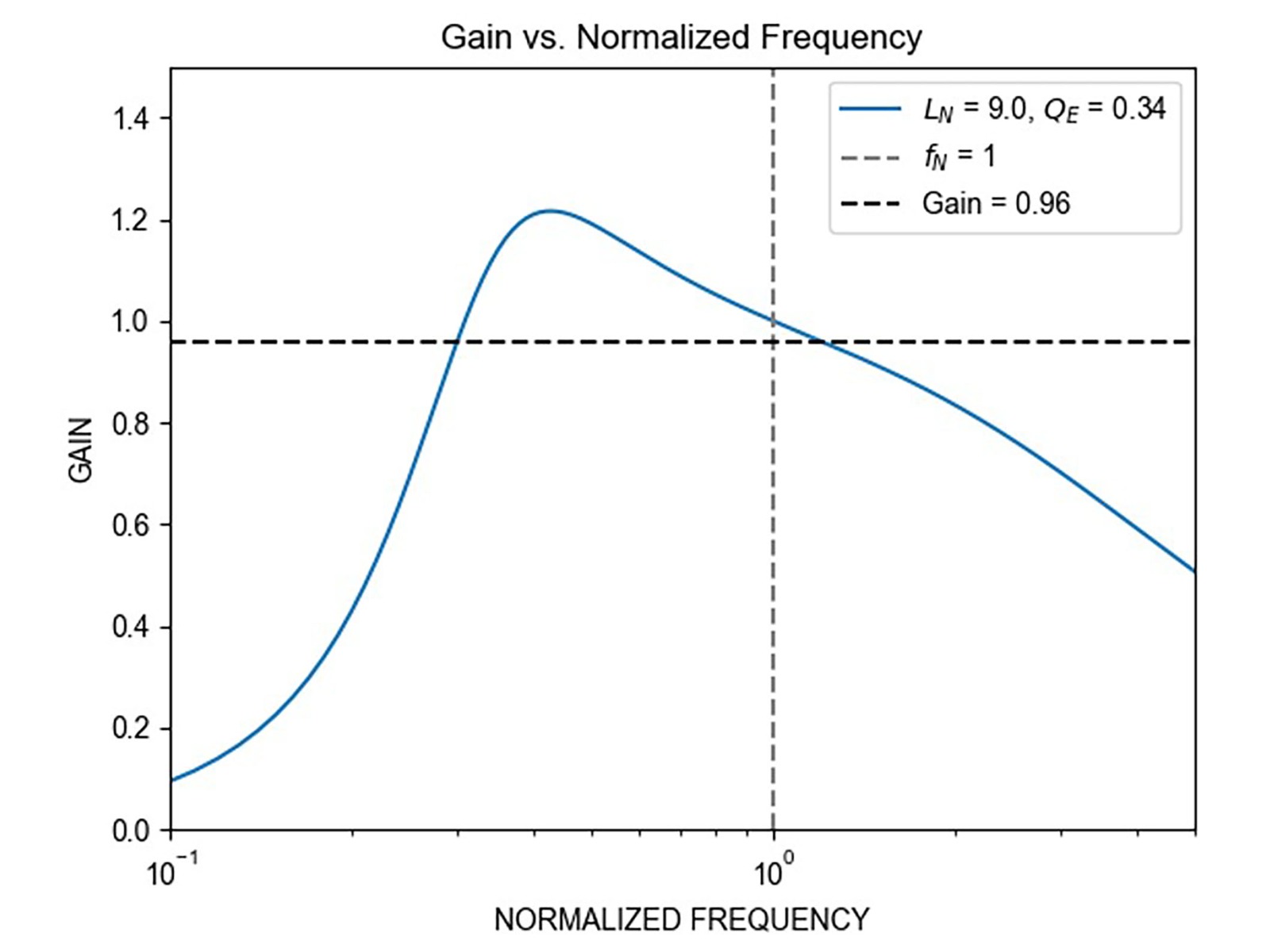

In the first scenario, VIN = 400V, LR = 27µH, CR = 94nF, and LM = 243µH. Figure 3 shows the resonant tank gain at VIN = 400V with 0.96 gain.
Figure 3: Resonant Tank Gain at VIN = 400V, Gain = 0.96, and fN = 1

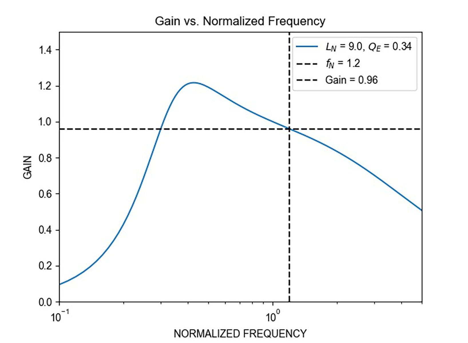

At fR, the gain is higher than necessary. To lower the gain to 0.96, the normalized frequency (fN) must be determined.
Figure 4 shows resonant tank gain after adding the calculated gain. The 1.2 ratio of fN coincides with the 0.96 gain, which are indicated by the grey and black dashed lines.
Figure 4: Resonant Tank Gain at VIN = 400V, Gain = 0.96, and fN = 1.2

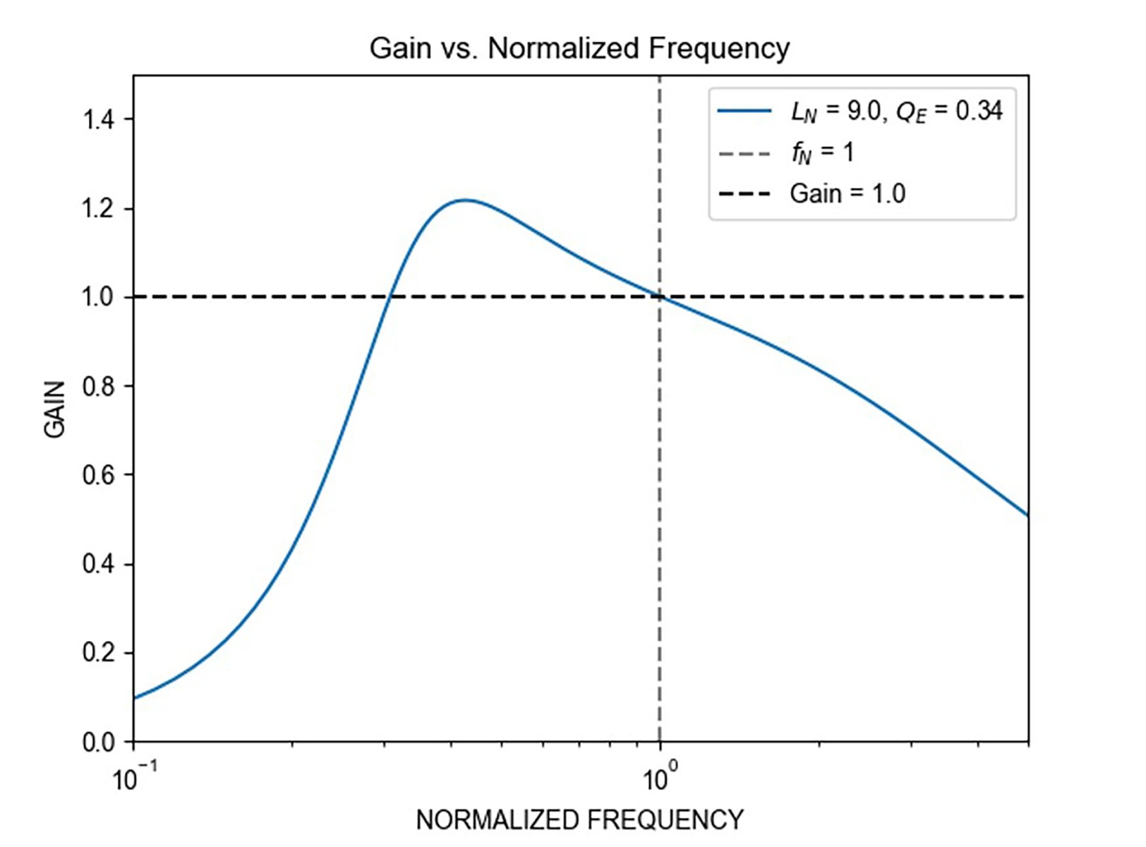

In the second scenario, VIN is reduced to 384V, while the other conditions remain the same (LR = 27µH, CR = 94nF, and LM = 243µH). Figure 5 shows the resonant tank gain at VIN = 384V, where the converter operates at fR with a unity gain.
Figure 5: Resonant Tank Gain at VIN = 384V
The second scenario is applied for step 8 and the final design, which are described below.

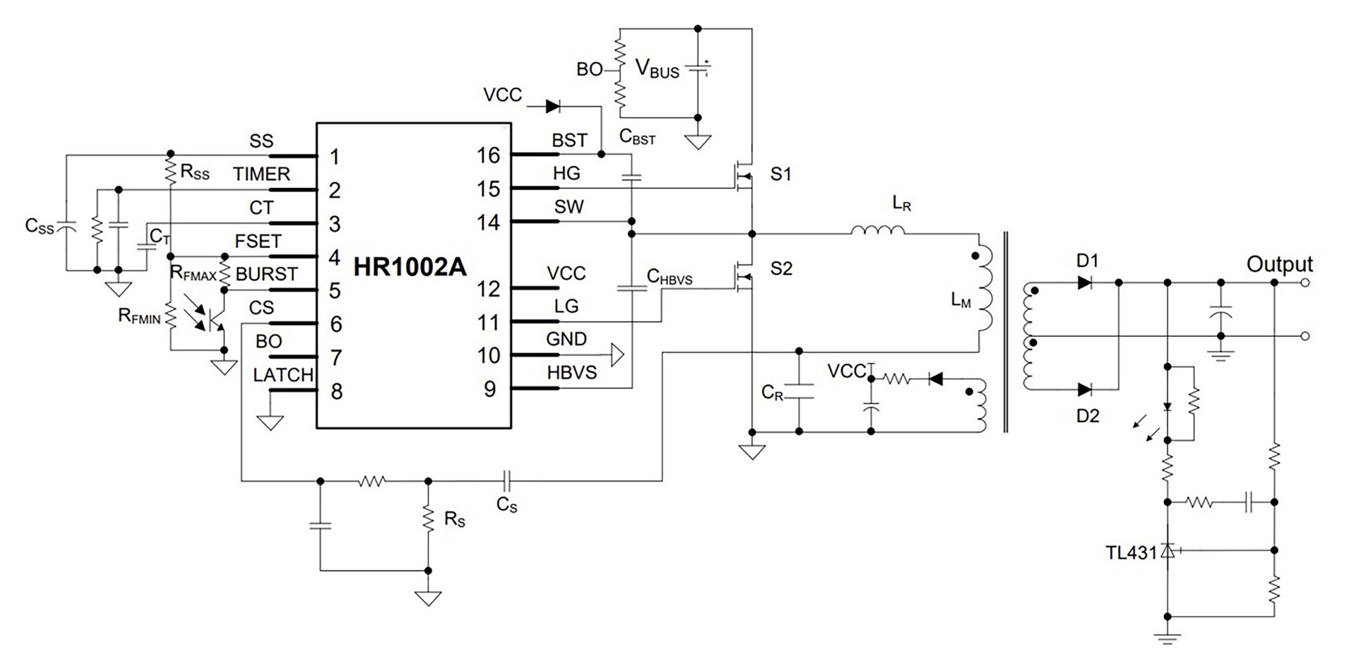

The HR1002A is an enhanced LLC controller that provides robust adaptative dead-time adjustment, (ADTA) as well as several protections, including shoot-through and capacitive mode protection (CMP) to avoid hard switching. There are also two over-current protection (OCP) levels, where one level provides a configurable delay for enhanced surge performance. Brown-in and brownout thresholds set the minimum VIN at which the converter can start working.
Due to the capabilities of the HR1002A, the power converter stage also requires only a few external components to function effectively.
Figure 6 shows the schematic of the half-bridge LLC with a center-tapped transformer using the HR1002A.
Figure 6: Half-Bridge LLC with a Center-Tapped Transformer Using the HR1002A
