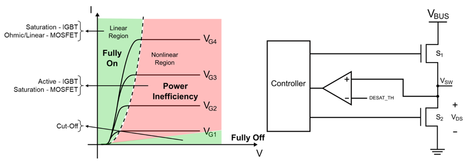

This charge accumulation at the gate can also cause other issues, such as desaturation. Desaturation is the process of a MOSFET involuntarily entering the nonlinear region. This operation region is highly inefficient, and is therefore never used for power conversion. Due to the increased power dissipation, not only will the system lose efficiency, it may even lead to the switches being destroyed. To avoid this, the DESAT protection circuit senses the voltage across the switch and stops powering the gate if it surpasses the desaturation threshold (see Figure 5).
Figure 4: MOSFET Operation Regions and Desaturation Protection Schematic
