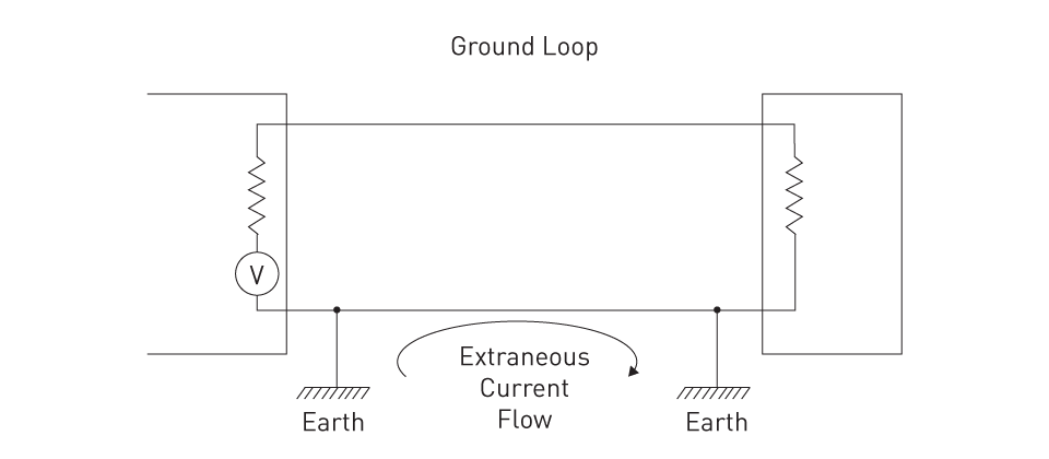

In electrical systems, ground loops are a common problem, especially in large installations with lots of connected components. When there are several paths to ground in an electrical system, a ground loop happens. This causes a cyclical flow of current that can cause interference and undesired noise in the signal lines. This phenomenon can cause buzzes, hums, or distortions in the visual field in audio and video systems, which makes it particularly problematic.
Figure 1: Ground Loop
A key strategy for avoiding ground loops is isolation. Isolation works by electrically dividing circuit segments, ensuring that every component has a single, dedicated path to ground and removing the possibility of circular currents. For instance, isolators are used in audio systems to break possible ground loops between various stages or devices (such as an amplifier and mixer), thereby maintaining the audio signal's quality.
Careful consideration of the circuit design, including the location of isolators and the management of ground connections, is required when implementing isolation to prevent ground loops. The intention is to avoid developing multiple, conflicting pathways by making sure that every component of the system is correctly referred to a single ground point.
