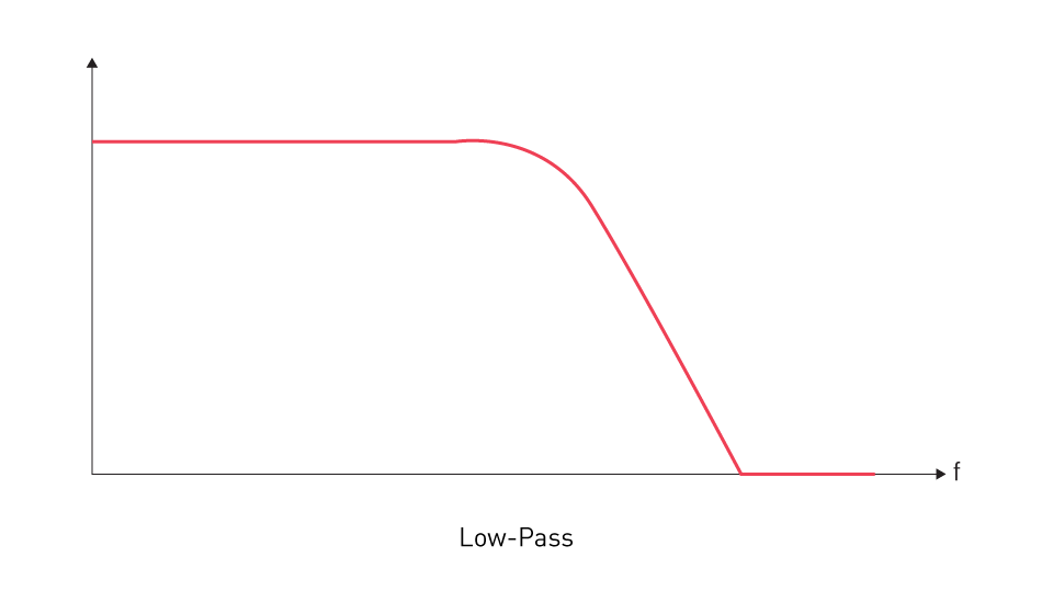

Low-Pass Filters: Low-pass filters are frequently employed to eliminate high-frequency noise, permitting only frequencies below a specific threshold, referred to as the cut-off frequency, to pass through.
Figure 2: Low-Pass Filter Frequency Response

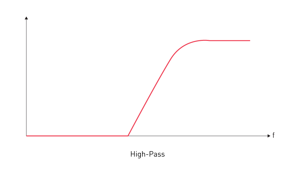

High-Pass Filters: High-pass filters are used to eliminate low-frequency noise and allow signals above a specific frequency to pass through.
Figure 3: High-Pass Filter Frequency Response

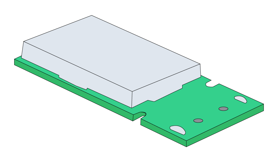

Principles of Shielding: The concept of shielding revolves around the creation of a barrier using conductive or magnetic materials. This barrier serves the purpose of preventing electromagnetic fields from either entering or exiting a designated area. Shielding is crucial for safeguarding sensitive circuits from external electromagnetic interference (EMI) and minimizing the emission of EMI from electronic systems.
Figure 5: EMI Shielding
Material Selection: When selecting the shielding material, various factors such as the nature of the EMI (electric or magnetic), the frequency range, and any environmental factors are taken into account. Typical materials used are metals such as copper or aluminum due to their excellent conductivity.
Enclosures and Shields: When it comes to achieving optimal EMI control, it is crucial to ensure that enclosures and shields are designed in a way that provides complete coverage to vulnerable areas. It is important to make sure that the shield is properly grounded and that there are no gaps or discontinuities that could weaken its effectiveness.

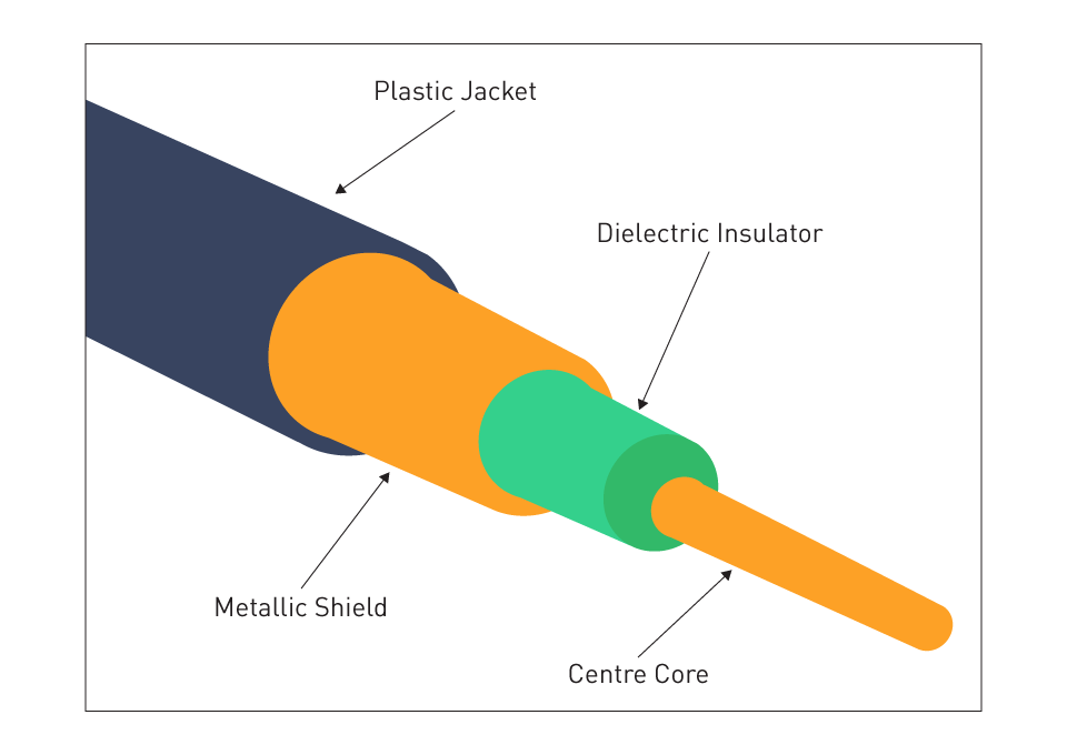

Cable Shielding: It is important to consider cable shielding as cables have the potential to act as antennas, which can result in the pickup or radiation of EMI. Utilizing shielded cables, which feature a conductive layer enveloping the core conductors, can help alleviate thiProper grounding of the shield is crucial for its effectiveness.
Figure 6: Coaxial Cable with Metallic Shield
