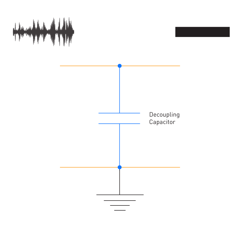

Decoupling Capacitors: The distribution of decoupling capacitors, employed to decouple one part of a circuit from another, can be even across the PCB. Decoupling capacitors, besides preserving signal integrity, also function as EMC filters, preventing high-frequency signals from transmitting throughout the PCB.
Figure 2: Decoupling Capacitor

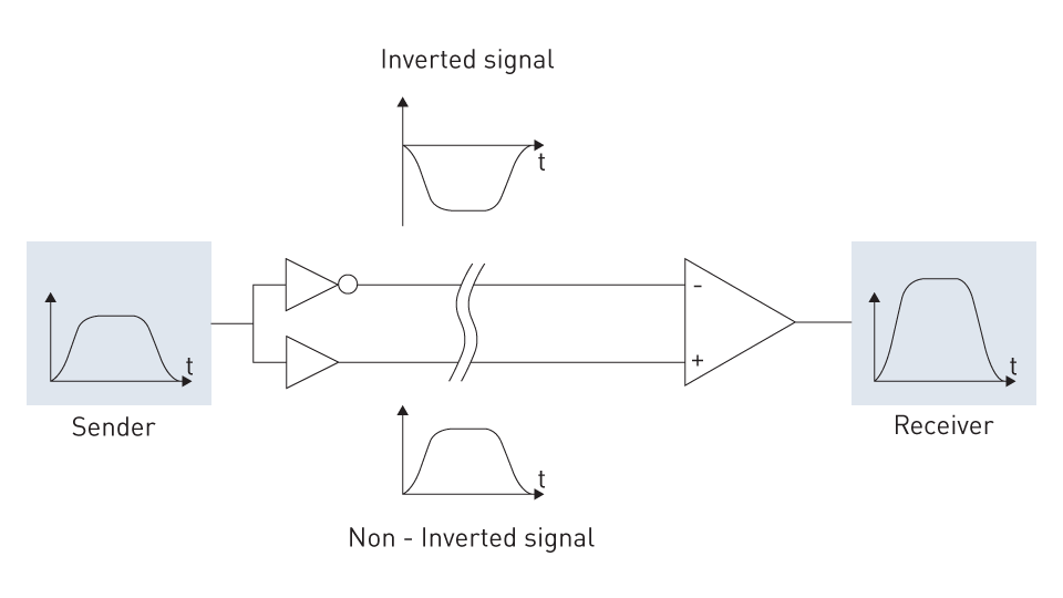

- Differential Signaling: The susceptibility to noise can inherently be reduced by employing differential signaling for data transmission. Improving the noise immunity of the system, differential pairs can filter out common-mode noise.
Figure 3: Differential Signaling
