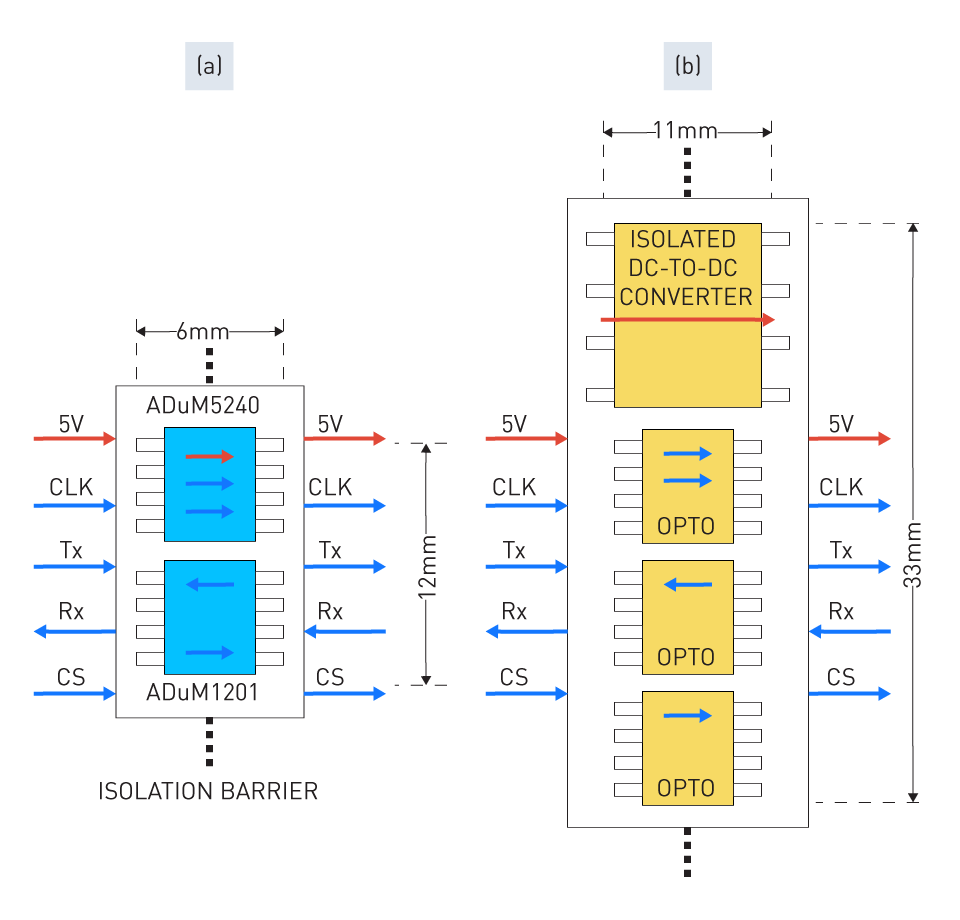

Size
In modern electronic systems, where space constraints are prevalent, the size of digital isolators emerges as a critical specification deserving particular attention. System design and integration are profoundly influenced by the physical dimensions of these components.
Importance of Compact : The demand for smaller elements, like digital isolators has been elevated as electronic devices become increasingly miniaturized. Applications such as portable devices, wearables, and space-constrained industrial controls frequently determine the suitability of isolators based on their size.
Factors Influencing Size
Isolation Technology: The size of the isolator is inherently influenced by the method of isolation employed, whether it be capacitive, magnetic, or optical. Capacitive isolators, for instance, can be crafted to be smaller compared to magnetic ones, due to the absence of heavy structures of transformer.
Figure 2: Isolators Based on (a) Magnetic Isolation and (b) Optocouplers
Integration Level: Incorporating multiple functions into a single chip, as seen in system-on-chip (SoC) designs, can drastically diminish the size of the isolator, thereby influencing the degree of integration.
Packaging Techniques: More compact isolators, without compromising performance, are made possible by advances in packaging technology, such as chip-scale packaging (CSP) and multi-chip modules (MCMs).
