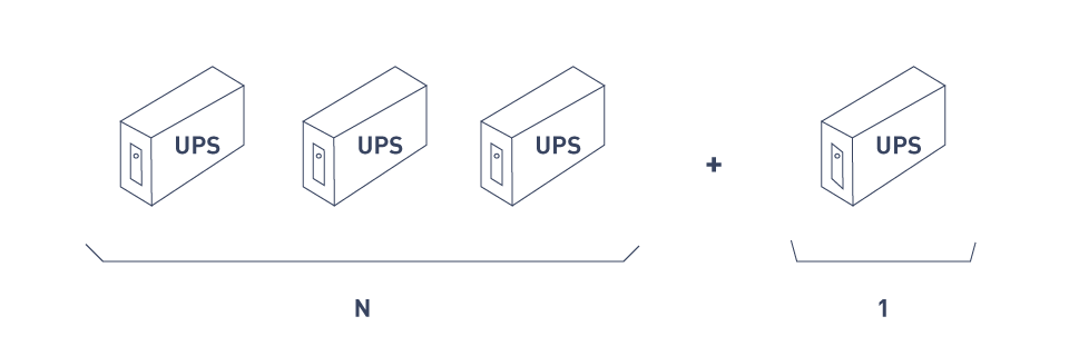

N+1 Redundancy: This is a popular setup in which there is one extra backup device (such as a generator or UPS) available in addition to what is required to manage the anticipated load. This configuration makes sure that service won't stop even if one of the parts fails.
Figure 11: N+1 redundancy
