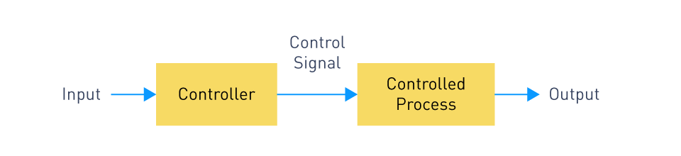

Open-Loop Control
Open loop control, otherwise known as "feedforward control." is a fundamental control method that is utilized with AC/AC converters." In this technique, the control action is solely controlled by the input signal and is not impacted by the output or any other form of system feedback. In open-loop control systems, the controller is responsible for determining the control signal by employing a predetermined algorithm. This is done without taking into consideration any disturbances or modifications that may occur to the system.
Figure 9: Open loop control
Characteristics of Open-Loop Control
Simplicity: Open-loop control systems are easier to develop and implement than closed-loop control systems. This is due to the fact that open-loop control systems are more simple. It is not necessary for them to have complex algorithms or feedback sensors in order to modify the control signal in response to the output. Consequently, they are now easier to construct, maintain, and debug than they were before.
Lack of Adaptability: One of the most fundamental drawbacks of open-loop control systems is that they are difficult to react to changes in the system or disturbances from the outside world. Due to the fact that the control signal is not updated depending on the output, it is possible that the system will not perform as planned in the event that there are any shifts in the system parameters or external influences that were not anticipated.
Stability: Open-loop control systems are often stable because they do not rely on feedback, which has the potential to produce oscillations or instability. However, this stability may result in reduced precision and adaptability when the system experiences shocks or undergoes changes in its features.
Applications of Open-Loop Control In AC/AC Converters
Techniques of open-loop control are utilized in a variety of applications involving AC/AC converters, including the following:
Simple Phase-Controlled AC Voltage Controllers: Simple AC voltage controllers usually use open-loop control, which is a method of controlling the output voltage by adjusting the firing angles of the thyristors. This control mechanism is particularly well-suited for applications like lighting or heating systems where precise voltage control is not required.
Basic AC/AC Chopper Circuits: Simple AC/AC chopper circuits can use open-loop control to adjust the output voltage. The switching devices modify their duty cycle to accomplish this. The requirements for the output voltage are not significantly altered by this approach, which makes it suitable for applications that have load characteristics that are well-known and consistent.
Basic Cycloconverter Operation: Open-loop control may be utilized in certain cycloconverter applications in which the desired output frequency is predetermined and known in advance. Under these conditions, it is feasible to construct the converter in such a way that it can deliver the desired output frequency without the need for feedback.
A lack of accuracy in the face of disturbances or shifting system characteristics makes open-loop control systems less suitable for applications that require precise control or flexibility. Despite the fact that these systems are straightforward and reliable, they are not ideal for applications that require either of these qualities. In these kinds of situations, closed-loop control strategies are often the ones that are preferred.

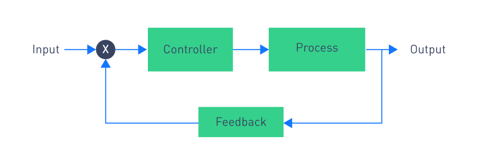

Closed-Loop Control
AC/AC converters use a more advanced control approach known as closed-loop control, which is also sometimes referred to as feedback control. This control method is characterized by the fact that the control action is reliant on the input signal and feedback. Closed-loop control systems are designed to continuously examine the output and make adjustments to the control signal in order to minimize the amount of error that exists between the desired output and the actual output. Because of this, the system is able to adapt to changes in system parameters as well as disruptions from the outside world, which results in improved performance and accuracy.
Figure 10: Closed loop control
Characteristics of Closed-Loop Control
Adaptability: The ability of closed-loop control systems to adjust to shifting conditions within the system or to disruptions from the outside world is one of the reasons for their widespread popularity. By continually monitoring the output and adjusting the control signal based on the feedback, these systems are able to maintain the target performance even in the presence of changes in the system parameters or even in the presence of external influences.
Accuracy: Closed-loop control systems are extremely accurate compared to open-loop control systems because they continuously change the control action based on the output. This is due to the continuous consideration of the output. Because they provide accurate output control, they are suitable for applications that require a high level of accuracy and precision.
Complexity: Closed-loop control systems are more complex than open-loop control systems because they require feedback sensors, control algorithms that process the feedback, and additional hardware or software components for the control action to be implemented. As a result, it is of the utmost importance to correctly design the systems, as failure to do so may result in potential stability difficulties, greater complexity, and increased costs.
Stability: Despite the fact that closed-loop control systems have the potential to perform better and be more adaptive, they also have the potential to cause oscillations or instability if the feedback loop is not constructed and calibrated correctly. For this reason, it is essential to keep a closed-loop system that is both robust and optimized in order to avoid performance issues.
Applications of Closed-Loop Control In AC/AC Converters
Applications involving AC/AC converters use closed-loop control strategies in the following ways:
Advanced Phase-Controlled AC Voltage Controllers: Phase-controlled AC voltage controllers are able to achieve precise and flexible voltage control through the use of closed-loop control. This makes them suitable for applications that have variable load conditions or demanding voltage regulation needs. Some examples of these applications include motor drives and delicate electronic equipment.
Advanced AC/AC Chopper Circuits: Closed-loop control can be applied in AC/AC chopper circuits to maintain a consistent RMS output voltage or current regardless of changes in the input RMS voltage or load situations. This is accomplished through the utilization of advanced air conditioning and alternating current chopper circuits. When it comes to applications such as renewable energy systems or power supply for sensitive loads, closed-loop regulated AC/AC choppers are an excellent choice because of their tight regulation and versatility.
Cycloconverters with Variable Output Frequency: Closed-loop control systems can be utilized to control cycloconverters in order to produce a variety of output frequencies that are determined by the feedback received from the output. Applications that require adjustable frequency control, such as adjustable speed drives or frequency converters for power systems, can benefit from their use because of this characteristic.
This makes closed-loop control approaches more suitable for applications that require precise control or adaptation to shifting system parameters or external disturbances. Open-loop control systems offer more flexibility and accuracy than closed-loop control approaches, which makes them more suitable for certain applications. Due to the additional complexity, however, careful design and tuning are required in order to preserve stability and achieve optimal performance, even if this comes at the expense of performance enhancement.
