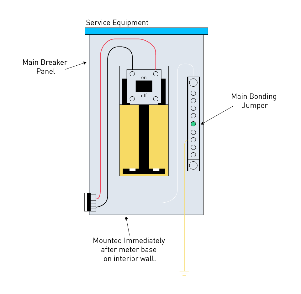

Bonding Jumpers
To keep many conductive components connected and at the same potential, bonding jumpers are utilized. Bonding eliminates voltage variations that could damage or shock equipment. To ensure the grounding system is safe and works properly, bonding jumpers are essential.
Types of Bonding Jumpers:
Main Bonding Jumper: Attached to the service equipment or main distribution panel, this jumper connects the equipment grounding conductor (EGC) to the grounding electrode conductor (GEC). It ensures the entire grounding system's integration by providing a direct conduit for fault currents to reach the earth.
System Bonding Jumper: In an independently derived system, like a transformer, this jumper links the neutral conductor to the grounding electrode conductor. By maintaining a constant potential between the neutral and ground, it stops currents from cycling and makes sure safety devices work as they should.
Equipment Bonding Jumper: The equipment bonding jumpers link different metal components that do not transport current either inside the equipment enclosure or between other equipment enclosures. To lessen the likelihood of electric shock, they level out any exposed metal components.
Figure 7: Main bonding jumper

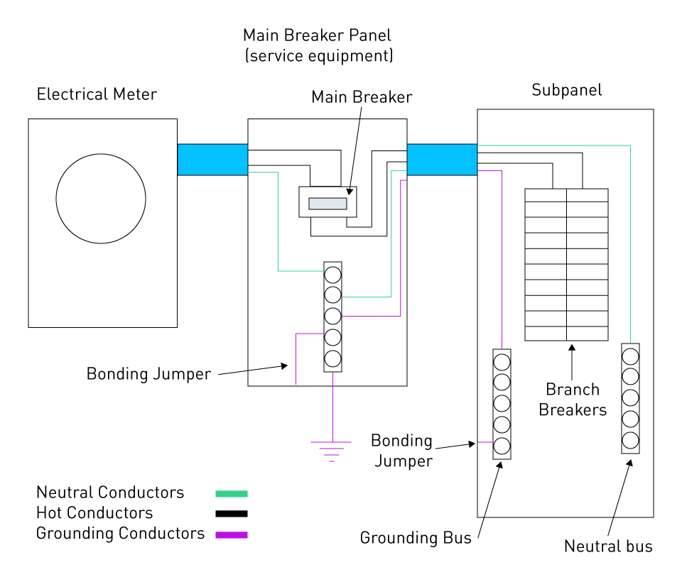

Grounding of Electrical Panels:
Main Service Panel: A grounding electrode system, consisting of concrete-encased electrodes, grounding rods, or plates, typically grounds the primary electrical panel of a house. Connecting the panel to the grounding electrode is a conductor for the grounding electrode.
Subpanels: The main panel grounds the subpanels, and a separate grounding conductor connects them to the main panel to ensure correct grounding continuity.
Figure 8: Main panel and subpanel grounding
