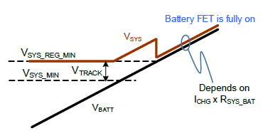

The MP2760 has a configurable VSYS_MIN. When VBATT < VSYS_REG_MIN (where VSYS_REG_MIN = VSYS_MIN + VTRACK), the BATFET driver controls the charging current loop (trickle charge, pre-charge, and linear constant-current (CC) charge). This ensures that VSYS is regulated at VSYS_REG_MIN.
When VBATT > VSYS_REG_MIN, the BATFET fully turns on, and the charging current loop (switching CC charge) and battery voltage loop (constant voltage (CV) charge) are implemented via the buck-boost converter’s pulse-width modulation (PWM) control. VSYS always tracks the actual battery voltage, which is limited above VBATT by VTRACK.
Figure 2 shows the system voltage regulation, where RSYS_BAT is the total resistance between the system and battery.
Figure 2: System Voltage Regulation

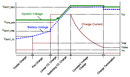

Figure 3 show the MP2760’s charging profile.
Figure 3: Complete Charging Cycle Profile

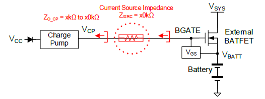

When VBATT is below VSYS_REG_MIN, BATFET works linearly. In 1-cell applications, the charge pump is powered by VCC, which is the internal LDO output that can provide a 3.6V voltage for the internal circuit. The charge pump’s input determines the maximum charge pump output (VCP). VCP is then used to drive the external BATFET via a current source.
The current source’s output impedance (ZISRC) should be several hundred kΩ, and the charge pump’s output impedance (ZO_CP) should be between several kΩ and several tens of kΩ. If the selected BATFET’s gate-to-source threshold voltage (VGS_TH) results in an insufficient DC voltage bias (about 2V) for the current source, then ZISRC drops to several tens of kΩ, and ICHG drops below its configured value (ICHG_CONF) due to inadequate loop gain. Therefore, a proper BATFET must be selected to meet the required minimum charging current (ICHG_REQ), especially for 1-cell applications.
Figure 4 shows the simplified block diagram of the BATFET’s linear on loop in a 1-cell application.
Figure 4: Simplified Block Diagram of the BATFET’s Linear On Loop in 1-Cell Applications

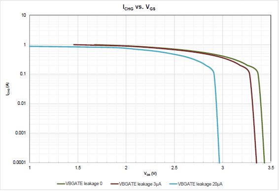

Figure 5 shows the relationship between the MP2760’s ICHG and the BATFET’s gate-to-source voltage (VGS) when ICHG_CONF is set to 1A, which reflects the driving ability under 1-cell applications. In 2-cell to 4-cell applications, the charge pump’s input is sufficiently high, and the current source that drives BATFET does not become saturated. Due to this, this application note only provides guidance on selecting BATFET in 1-cell applications.
Figure 5: ICHG vs. VGS of the MP2760’s BATFET (ICHG_CONF = 1A)

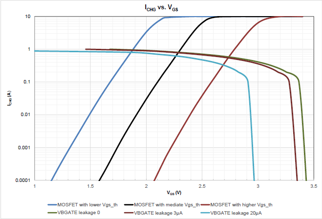

Figure 6 shows the transfer characteristics of three different N-channel MOSFETs. These characteristic curves are paired with the curves from Figure 5 on page 4.
Figure 6: Estimated ICHG When the MP2750's BATFET Works Linearly with Different MOFSET Types (ICHG_CONF = 1A)
Based on Figure 6, it is possible to estimate the BGATE pin voltage (VBGATE) and ICHG values for different MOSFET types. Table 1 lists the estimated VGS and ICHG values to select a MOSFET with the optimal transfer characteristics.
Table 1: Estimated VGS and ICHG Values(1) (2) (3)

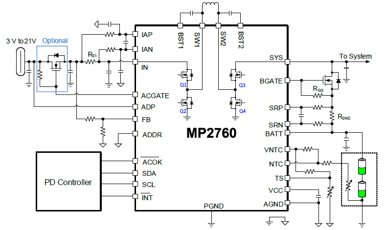

Figure 7 shows the MP2760’s typical application circuit.
Figure 7: Typical Application Circuit of the MP2760
