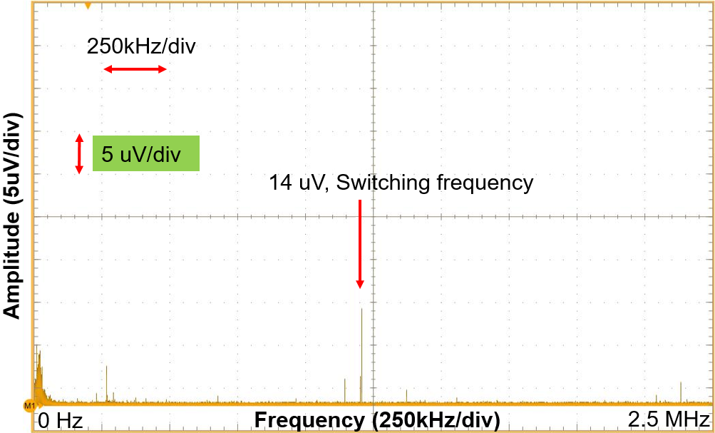

The FFT results of the output noise measurement of the EVREF0102A are shown in Figure 9. As shown, the peak noise at the switching frequency is reduced to 14µV.
Figure 9: Output Noise Measurement of the ADC_AVCC Rail of EVREF0102
