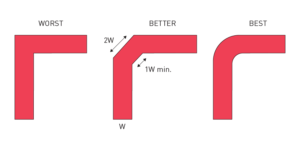

Avoiding Right Angles:
Smooth Transitions: It is important to steer clear of right-angle bends when routing traces for high-speed signals since these bends might result in impedance discontinuities and increase radiated emissions. If you want to make transitions that are smoother, use angles of 45 degrees or curved traces.
Figure 3: Trace Bending Practice for High-Speed Signals
Gradual Bends: This reduces the likelihood of signal reflection and improves signal integrity.

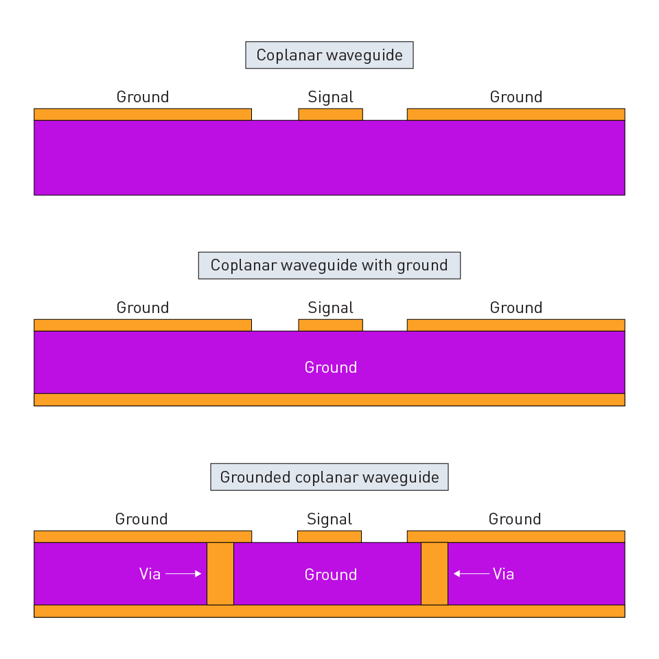

Grounded Coplanar Waveguide: The use of grounded coplanar waveguide constructions for radio frequency (RF) traces is recommended in order to decrease radiation and restrict electromagnetic fields.
Figure 7: Different Solutions for Coplanar Waveguide

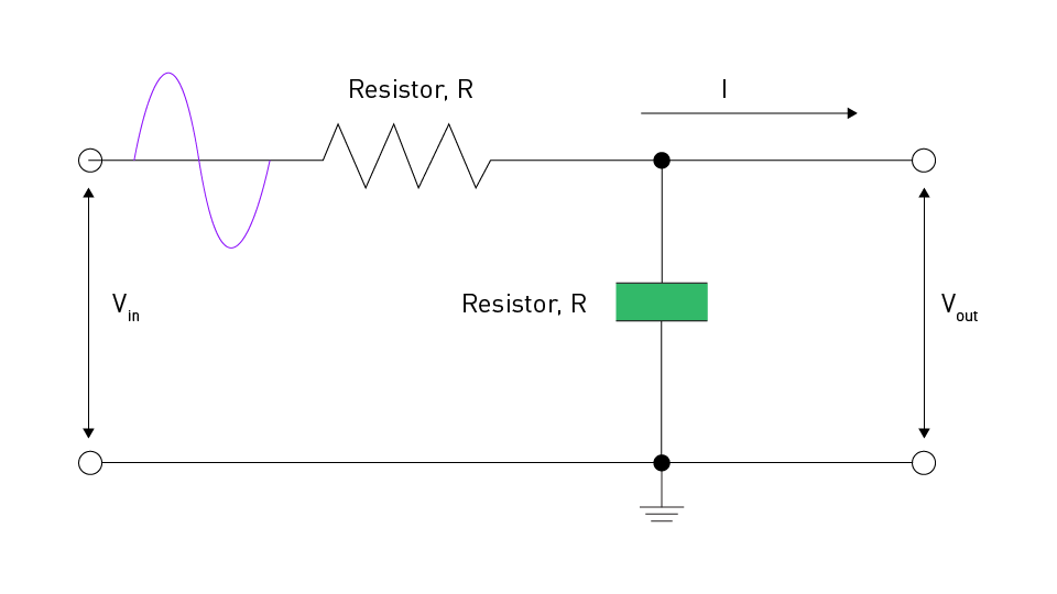

Low-Pass Filters: When low-pass filters are used, they allow low-frequency signals to get through while attenuating noise that is of higher frequency. capacitors, inductors, ferrite beads, or a mixture of the two are frequently used in the implementation of this technology. There is a decent rule of thumb that states that the cut-off frequency of the filter should be placed one decade below the frequency of the noise that is of interest in order to reduce the noise by at least 20 dollars.
Figure 9: Example Resistor-Capacitor Low-pass Filter

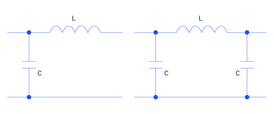

Pi Filters: For efficient power line filtering, use Pi filters, which are a configuration consisting of capacitors, inductors, and capacitors. There is low-pass filtering provided by this topology, which reduces the amount of high-frequency noise that is coming from both sides.
LC Filters: Combining inductors and capacitors results in the formation of LC filters, which may be used on both signal and power lines. Choose the values of the components depending on the cutoff frequency that you want to achieve and the characteristics of the noise that you want to eliminate.
A reasonable rule of thumb to follow when selecting the cut-off frequency for LC filters is to choose a frequency that is at least ten years lower than the frequency of the noise of interest.
Figure 10: LC Filter and PI Filter Topology
The cut-off frequency of an LC filter can be calculated by the Thomson formula:
