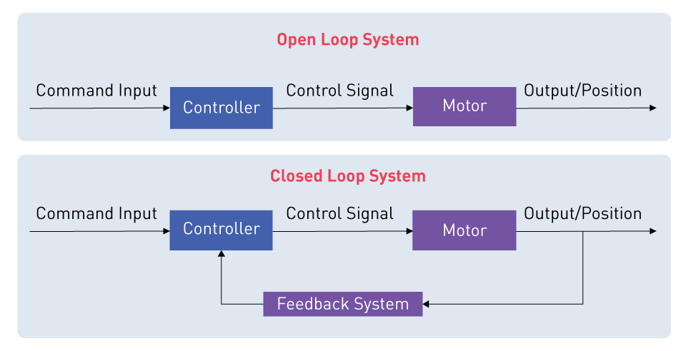

Overview of Open-loop and Closed-loop Control System
The existence or absence of feedback mechanisms distinguishes the two primary categories of motor control systems. These categories are open-loop and closed-loop systems.
Open-Loop Control Systems: In an open-loop system, the performance of the control action remains unaffected by the outcome. This implies that the system operates based on preset settings, making no adjustments to accommodate load fluctuations or environmental conditions. Open-loop systems are both easier to use and less expensive than closed-loop systems, but they do not possess the same level of precision or adaptability. They are ideal for inclusion in applications in which precise control of speed, torque, or position is not of the utmost importance.
Closed-Loop Control Systems: Closed-loop control systems use feedback mechanisms to adjust the control action based on the output. Sensors monitor the motor's performance and provide real-time data to the controller. The controller then makes adjustments to the motor's function in order to achieve the desired result. This feedback loop allows for precise control over the motor's speed, torque, and direction by accounting for disturbances and load variations. Robotic arms, CNC machines, and automated assembly lines are examples of applications that require a high level of precision and hence require closed-loop systems.
Figure 1: Open-Loop versus Closed-Loop System

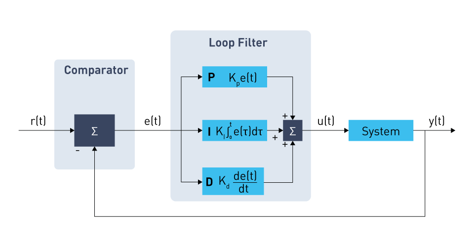

PID (Proportional, Integral, Derivative) Control and Its Applications
Motor control systems widely recognize PID control as one of the most widespread and efficient control schemes on the market. It adjusts the motor's input based on three parameters: the proportional (P), integral (I), and derivative (D) terms. There are three types of errors: the proportional term handles the current error, the integral term takes into account the accumulation of errors from the past, and the derivative term forecasts errors that will occur in the future. Examples of applications that make extensive use of this control approach include conveyor belts, robotic arms, and CNC machines. These are all examples of applications that require precise control of speed and position. PID controllers are highly regarded for their adaptability and ability to significantly increase system stability and response time. As a result, they are ideal for dynamic systems with varying loads and operating conditions.
Figure 2: Depiction of the PID Control Loop in the Time Domain
The system subtracts the sampled signal, y(t), from the input signal r(t), which could be the controller's torque or speed demand. This is something that we can observe. The symbol e(t) denotes the produced error or difference, which the PID filter then sends. The three components of the PID filter individually modify the error signal, subsequently combining the transformed value with the other values. The motor will adjust to a new value, known as the control variable, as a result. This shifts the value of y(t) towards the desired value, represented by r(t). The PID filter in the loop ensures that y(t) closely follows r(t) and minimizes e(t) close to 0. This ensures that the loop is functioning properly.

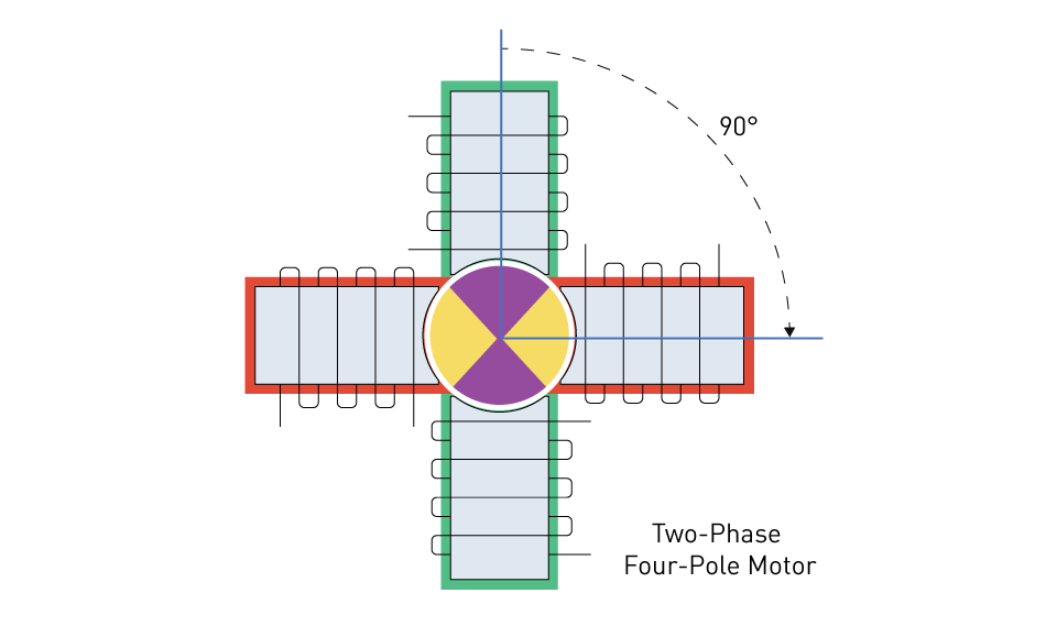

Full Step: The motor moves through its basic step angle, which is typically 1.8 degrees for a 200-step motor, for each and every pulse that it receives when it is operating in full step mode. This mode provides the highest possible torque because it energizes the greatest possible number of windings without those windings overlapping. This material is excellent for applications that require high speed and torque, although it does not necessarily require high precision.
Figure 3: Full-Step Mode

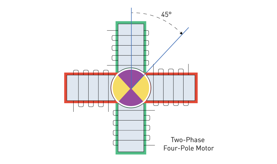

Half-Step: Half-stepping is a technique that involves alternating between energizing two phases and energizing a single phase. This technique efficiently reduces the step angle by half while simultaneously increasing the resolution by two times. Compared to full stepping and other modes, this mode improves smoothness and spatial resolution but decreases torque.
Figure 4: Half-Step Mode

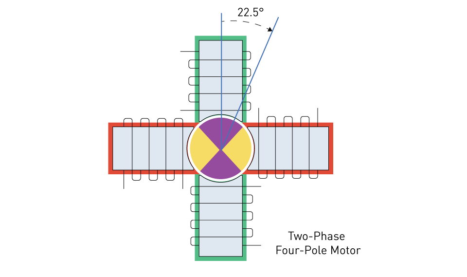

Microstepping: This technique separates each entire step into smaller steps, resulting in a significant increase in the motor's resolution. The stepper motor is controlled in this mode to achieve smoother motion and more precise control, but at a somewhat reduced torque. This mode is utilized to achieve these goals. The microstepping technique is especially useful for applications that require extremely precise positioning and fluid movement.
Figure 5: Microstepping Mode
