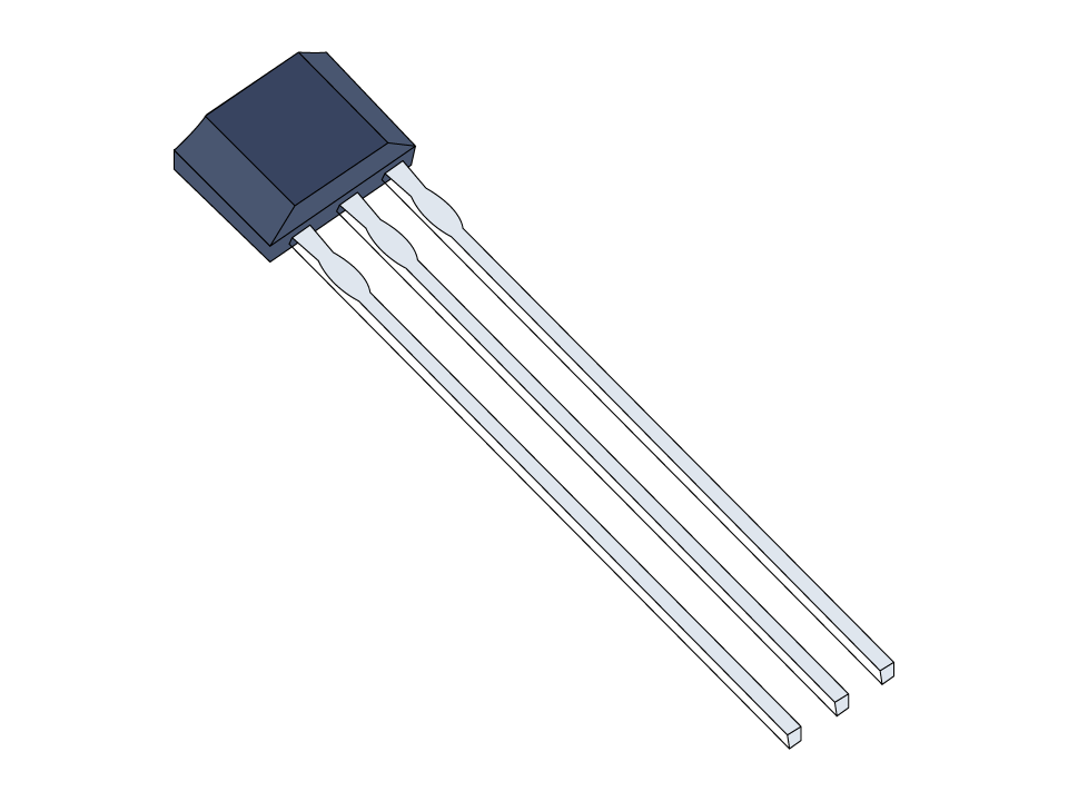

Hall-Effect Sensors
Since Hall-effect sensors are sensitive to magnetic fields, they have a special place in the world of magnetic sensors and can be used for a wide range of purposes.
Figure 1: Hall-Effect Sensor

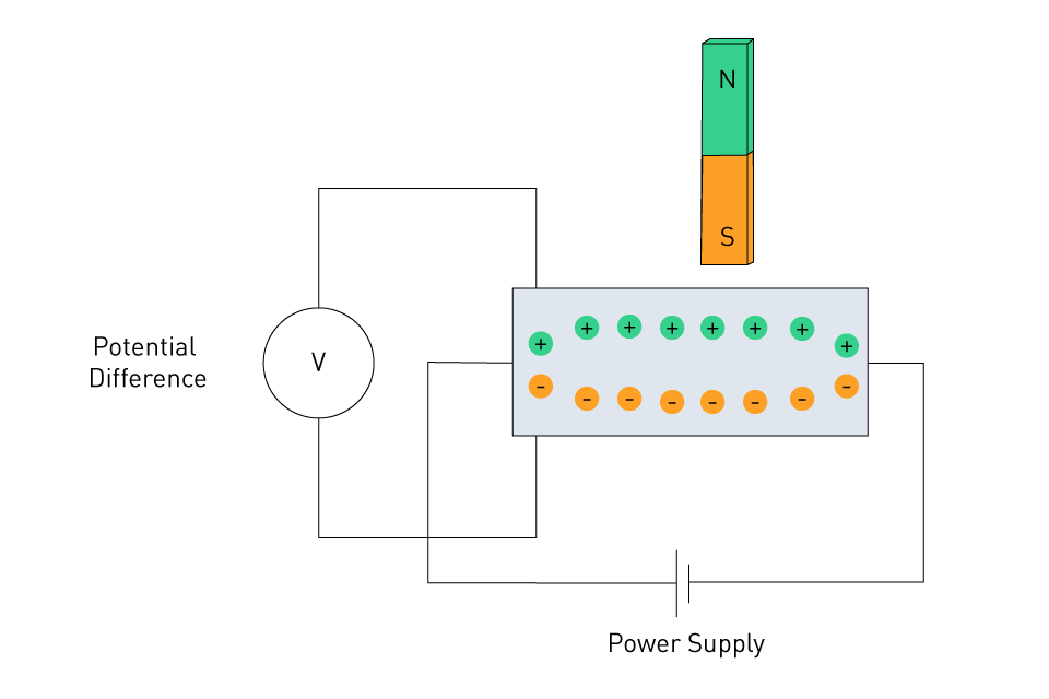

Working Principle
Edwin Hall established the Hall-effect concept in 1879, which serves as the foundation for Hall-effect Sensors. A voltage across a current-carrying conductor positioned perpendicular to a magnetic field is produced, which is perpendicular to both the magnetic field and the current flow. We call this phenomenon- the Hall effect.
A thin conductive substance is exposed to a current flow in a Hall Effect sensor. This material generates an induced Hall voltage when it comes into contact with a magnetic field that is perpendicular to the current flow. The product of the magnetic field strength and the current is directly proportional to the Hall voltage. By converting the Hall voltage into an equivalent electrical output, the sensor is able to determine the existence and strength of the magnetic field. In order to infer details about the magnetic field or its source, this output can then be monitored, conditioned, and examined.
Figure 2: Working of a Hall-Effect Sensor
An important consideration for Hall sensors is the angle of approach, the angle at which the current carrying conductor or trace and its associate magnetic field interact with the sensor. Each sensor has an acceptable range for angle of approach. The sensor will not give an accurate measurement if the angle of approach is outside this acceptable range.

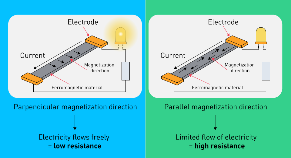

Anisotropic Magneto-Resistive (AMR) Effect
The phenomenon where a ferromagnetic material's electrical resistance shifts in response to an external magnetic field supplied in a favored direction is known as the anisotropic magneto-resistive effect. Because of the intrinsic anisotropy of the AMR effect, the resistance change is contingent upon the angle formed by the direction of the magnetic field in the material and the current flow. AMR sensors are very flexible and efficient in detecting magnetic fields because of this feature, which allows the sensor to identify not only the magnetic field's presence and strength but also its direction.
Figure 3: Working of an AMR Sensor
The ferromagnetic material's resistive properties are changed when an external magnetic field is applied because it realigns the magnetic domains within the material. Following measurement, the induced resistance change is transformed into an electrical signal proportional to the strength of the magnetic field. This signal can then be processed and interpreted for a variety of uses.

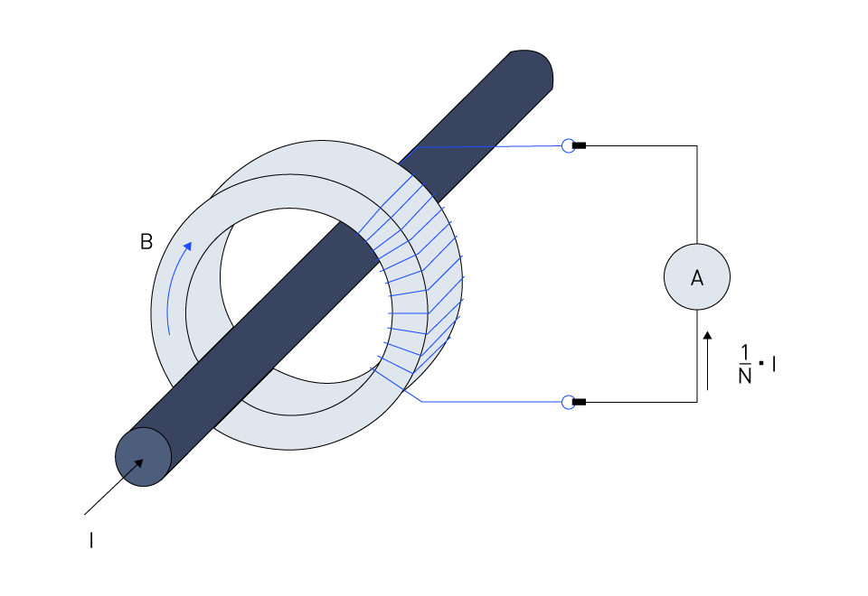

Transformer Principle: In order to measure the primary current, current sensors also work on the transformer concept, in which the magnetic field created by the primary current causes a secondary current to be induced in a coil coiled around the conductor.
Figure 6: How a Current Transformer Works
