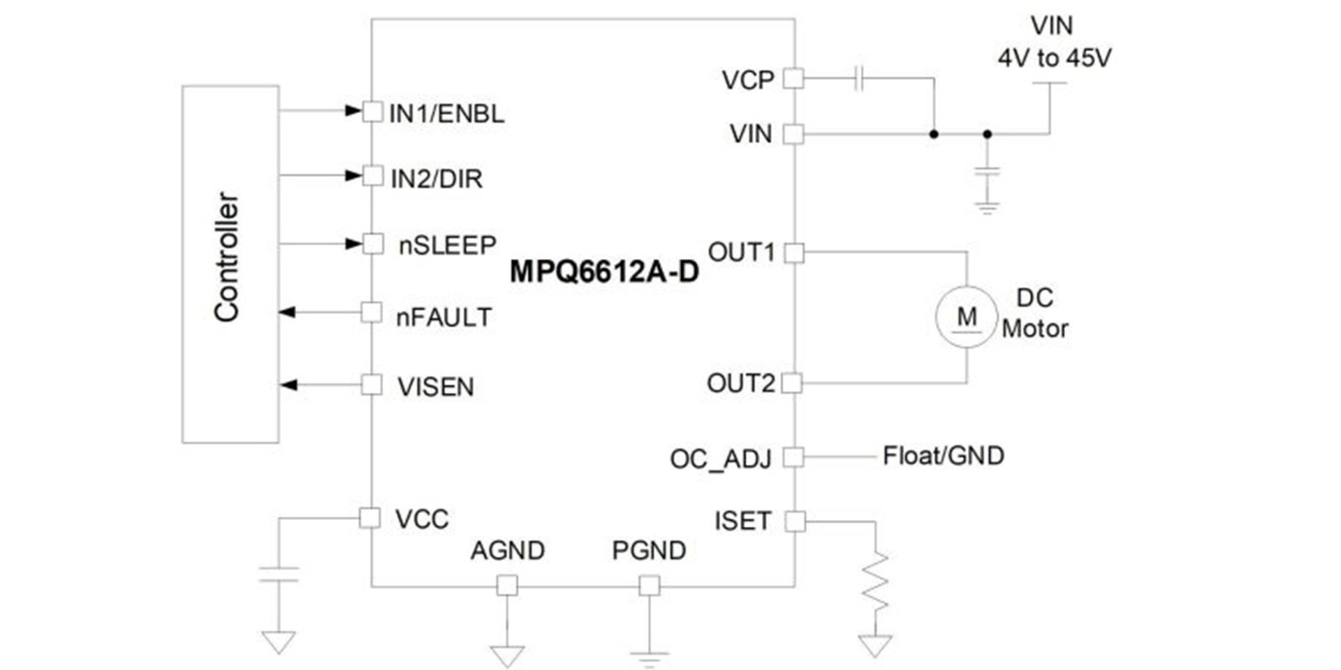

The MPQ6612A-D-AEC1 is another H-bridge motor driver that can be used in solenoid drivers to provide precise control of DC motors, stepper motors, and other loads. The MPQ6612A-D-AEC1’s reversible motor driving capability enables and disables the solenoid driver by managing the input signals to the H-bridge. It can be used in infotainment systems as well as automotive displays (including navigation, heads-up, and cluster).
Figure 3 shows the MPQ6612A-D-AEC1’s typical application circuit.
Figure 3: MPQ6612A-D-AEC1 Typical Application Circuit
