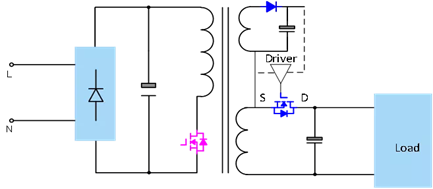

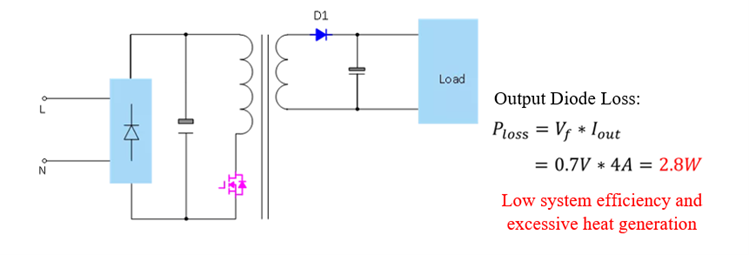

Figure 2 shows a commonly used flyback topology, assuming a system output of 5V/4A, where the average current flowing through the side diode is 4A. If there is a 0.7V due to pressure drop and 2.8W of power loss, the diode can become dangerously hot. In this scenario, the system’s long-term operation can seriously affect reliability and user experience.
Figure 2: Excessive Heat on a Flyback Topology

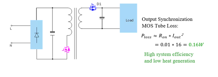

To address the challenge of excessive heat, the side output diode should be replaced with a MOS tube. The continuous flow of the current through the MOS tube forces the system to operate in synchronous rectification mode (see Figure 3). Because the impedance of MOS tube is very small, the heat generated during the continuous flow is also very small. For a MOS with a 10mΩ impedance, the power loss is only 0.16W when the output current is 4A. This significantly reduces heat generation.

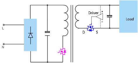

Figure 4 shows that for N-channel MOSFET, a voltage exceeding the source-to-gate (S-to-G) voltage must be provided to turn on the MOS tube during continuous flow, where the highest voltage is located at the source.

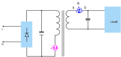

Auxiliary windings can also be used to provide a voltage that exceeds the source voltage. Figure 5 shows additional windings that power the side MOSFET’s drive. However, this approach requires a transformer winding and drive circuit, which increases system cost and complexity.

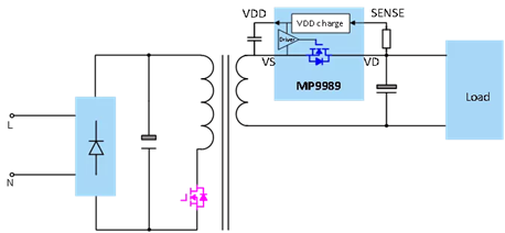

The critical design question is how to select a scheme that improves EMI performance without requiring either auxiliary windings or adaptability for different output voltage applications. The MP9989, a continuous conduction mode (CCM) and discontinuous conduction mode (DCM) flyback diode, can mitigate these issues (see Figure 7).
Figure 7: The MP9989 Improves System EMI Performance

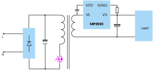

The MP9989 can be placed directly at the output’s high end. It also supports low output voltages and features a simple peripheral circuit, which is considered the ideal diode. The main advantage of the MP9989 is its internal, self-powered circuit.
Figure 8 shows that when the primary-side MOSFET is turned on, the MP9989’s MOS tube reverses, and the drain-to-source voltage (VDS) is positively pressurized. This allows the internal, self-powered circuit to charge the VDD capacitator. When the primary-side MOSFET is switched off, VDD can supply power to the drive circuits using the charged VDD capacitor. This ensures the smooth opening of the primary-side MOSFET.
Figure 8: An Internal, Self-Powered Circuit Charges the VDD Capacitor
As USB powered devices (PDs) becomes more common, the output voltage range is increasing. Higher output voltages can challenge the chip’s voltage resistance. To counteract this, the MP9989 has a built-in, 100V MOSFET that provides a sufficient margin for a wide range of designs.
